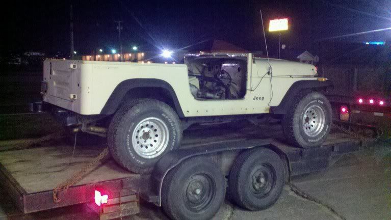

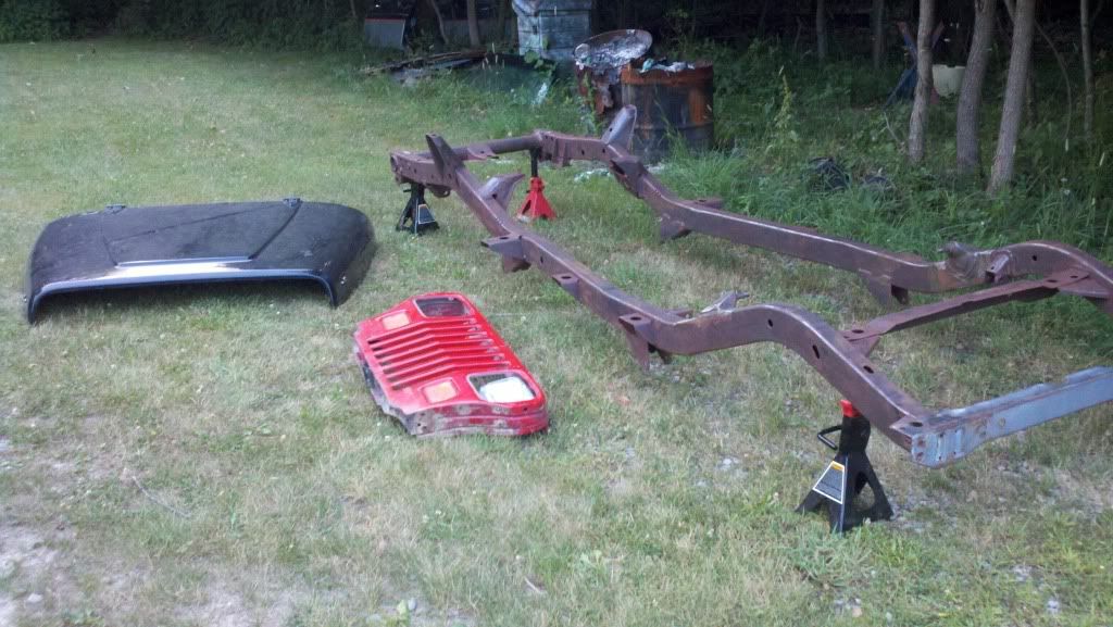

I never thought I'd be doing a total build thread on here. lol. So the patient is my 95 Rio Grande.
Ive had her since the winter of 02-03 and its been the only vehicle I've owned. Now she's in need of a new frame and body. Just the other day (after about a 2 month search), I found this little gem for only $200! Plus I got a hold of a near mint hood and front grill for $50 a piece.

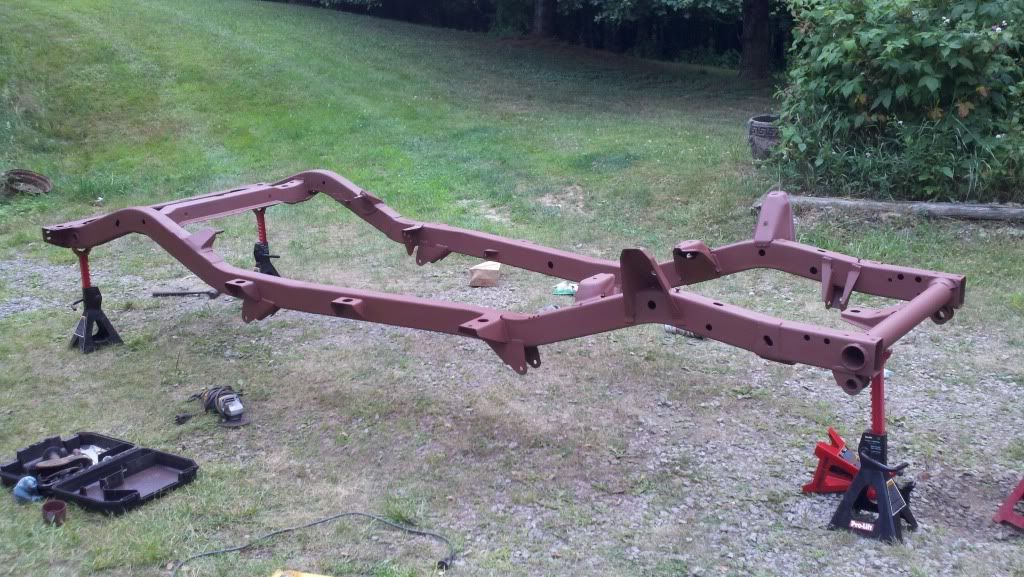

Today I worked on the frame for about 7 hours taking off all the surface rust from sitting in the guys garage for a couple years. Its just in primer now because I still have to dump some por-15 down the frame rails. The PO took it to work and actually baked it in a furnace to get all the old paint off. I want to get a couple welds fixed too just to make me feel more comfortable.

Just a few steps of progress. Today I por15'd the inside of the frame. It was a lot simpler than I thought it would go. I just taped up most of the holes and filled it up. I did it with about a quart and a half. (stuff is pretty expensive at $50 a quart) I could of done it with only a quart but I didn't get all the holes plugged.
All I did was just fill it from the top and roll it around on the lawn. Makes the neighbors look at you kinda funny.
I think just a pint more just to touch up a couple spots inside but its really almost 95% covered. The stuff is really runny and spreads easy. Its also impossible to get off your fingers. The last thing I did was drill a small drain hole in the little catch part on the front rear crossmember and spread a little por15 for extra insurance.
Only thing I would of done different is to fill it on the side instead of from the top. Less drops and bends so it would spread easier.

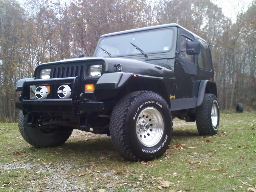

That pic was from the good side over a year ago. This winter was really tough on it. Shes got rust spots showing through on both sides now. I mostly just want to put all my good stuff on a new tub and frame with just a 1" body lift. The main goal is to just get it looking nice for a big jeep fest coming up in august.

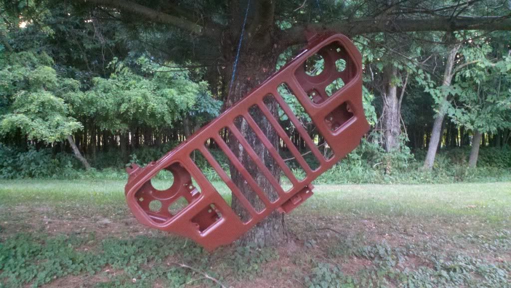

Just stripped down and wire brushed a little rust off my new grill and primed it. Now I just need some spot putty and some paint to finish.

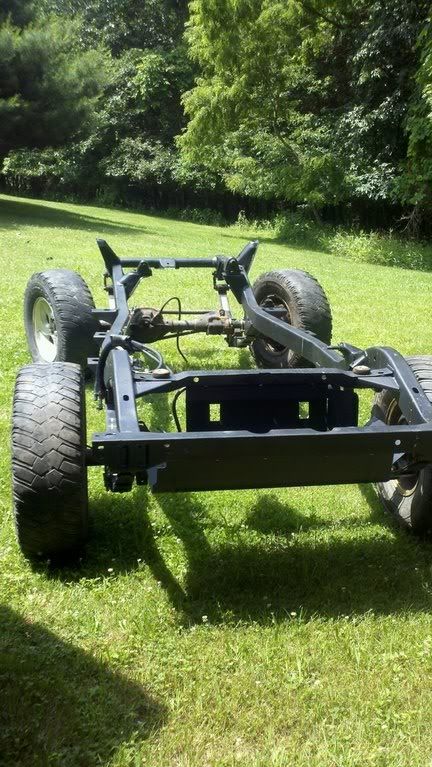

So I'm starting the build back up! I finally have a stable DD with my cherokee and I'm done with all the stuff to keep that going. Just to bring yins' up to speed, we left off with me searching for a new tub. I found one the summer of 2012 up by Pymatuming lake. Nice tubs are extremely hard to find in the salt belt.

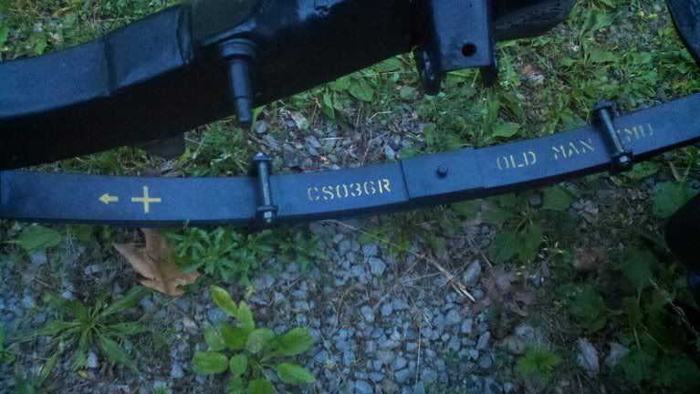

It needed some firewall work and a new drivers side floor but was mostly rust free. I sold everything but the 4.10 axles, tub, and gas tank. My uncle was able to do the welding for me. I bedlinered the whole inside and most of the underneath but I still have some to do in the back. Thats going to have to wait until this snow finally stops. It sits right now as a rolling chassis with the 4.10's and a brand new gas tank and tranny skid. The tranny skid is a heavy duty one with a 1" drop built in to it. I spent the extra cash and went for the OME 2.5" 36r's all the way around for the lift.

Now just to make this all transfer onto the new frame. lol
Thought I'd do some resto to the bumper and push bar while the snow was still flying.
