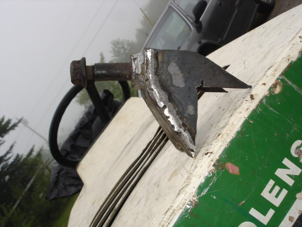

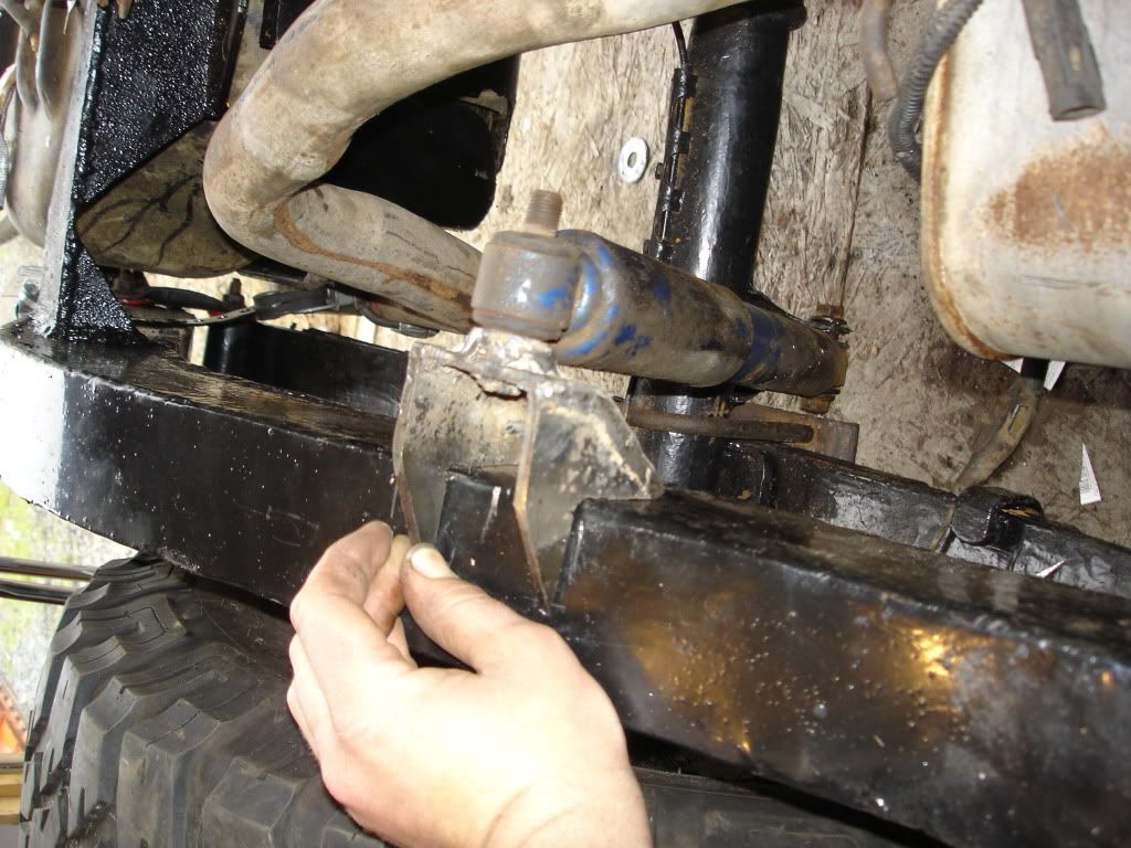

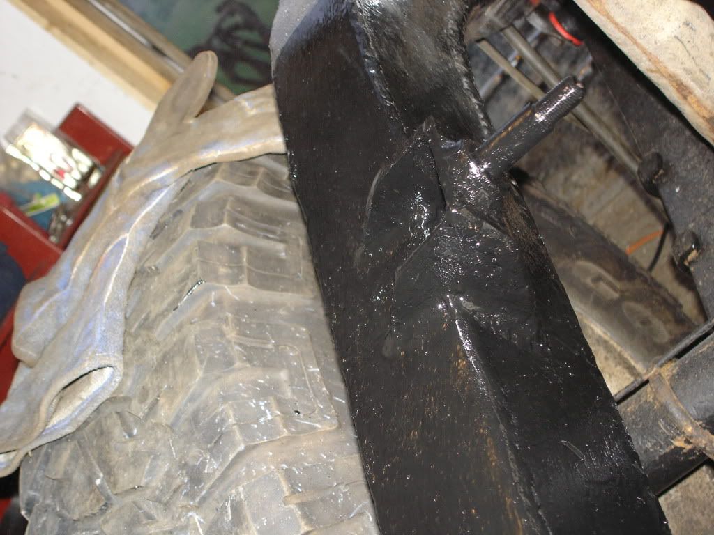

I made my own shock mounts during the frame repair, only took a few minutes.... used 3/16 steel and old mount bolts

Nice work!! That will save me some cash. That's why I love this forum. You guys are always willing to show your techniques. I think I need to buy a plasma cutter. I already have a mig. Thanks Trucknut.
