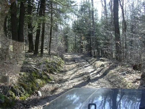

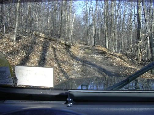

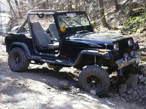

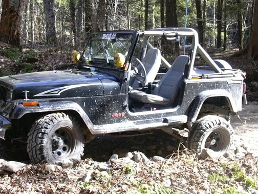

well, did a little off roading today. nothing worse than fire roads, but that's about all there is around here. i'm happy to say that the frame has held up without so much as a flinch. here's some pics.
my favorite sign
some shots of the "road"
as you can see, nothing 2wd couldn't handle but it was rough enough to get the suspension moving. found a little ditch to do some flexing in:
i did find that my new front brake lines are a bit shorter than the old set (had to replace them for the inspection over the winter) so i'm going to try relocating them below the frame rail before i do any more flexing. so all is well and i'm chalking this repair up as a success! the real test will be the 30th, but i'll continue testing until then.

Location: Just north of Calgary, Alberta, Canada
Posts: 2,990
Originally Posted by sentinal02
I think I see a crack forming on the d/s of the frame ..
Formally 88Jeepster
Who's in front ?
Ridin' topless again .. sweet !!
Wif is offline
