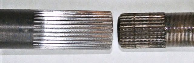

31 spline chromo on the left, factory 28 spline on the right.

I agree with most everything you said above. I never said the 9" ford is junk, i said the 28 spline shafts are junk.
My issue with Apollos is hes touting the strength of the 28 spline, mainly because hes already bought a 28 spline detroit for it and hes already into it some coin. So he wants it to be superaxle. Im sorry, it simply wont be. I wasted ALOT of cash trying to get 28 spline to hold up to just 35s. It wont fly. I learned the hard way, hate when others have to. Ive beaten the piss out of the 31 splines with zero issues for over a year now.

I'm already saving up for a 31 spline setup anyway, you assume too much by previous threads. I found out a few days ago that the outer flange of the 28 spline shafts I have were bent by a wreck the previous owner had gotten into without telling me. So my 28 spline shafts are on their way out as I have currie custom 31 spline shafts on their way at the moment. Got to wait a week to get the 31 spline detroit.
So chill on directly calling me out, my posts weren't really directly joking about you in the first place, quit being so sensative. I was arguing about JF being against the ford 9" swap AS A WHOLE, not specifically to you and your unbelievable anger toward 28 spline shafts. Ironworker and myself were simply ranting about the benefits of a ford 9" AS A WHOLE above some of the other popular axle swaps out there... You simply cannot tell me that a 28 spline ford 9" isn't better then say... a super 35...
I don't intend to argue that a 28 spline axle shaft will hold up the same as a 31 spline, despite how much I wished it would have a few weeks ago before I bought the 28 spline detroit lol, but nothing I can do about that now. Yes the 31 spline pwns the 28 spline, but the 28 spline still detroys many other axle swap options out there. That was the ONLY point I was trying to make.
