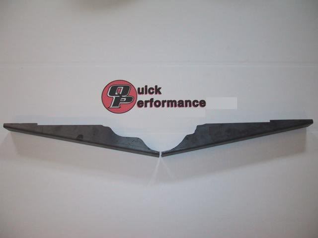

So.... I'm wanting to truss my 9" but I don't feel like trying to fab one up (as the metal shops in my part of florida are out of their minds in price) so I found this $44.00 deal on ebay and it seems like it would do the job and you cant beat the price. Just wondering what you guys think (strength-wise) and they are 1/8th btw, I can always add alittle more metal but this would give me a great base to start with.
Most of the time when I see a trussed axle it is trussed on the top so that the rear diff cover can come off, in the case of my ford 9" there is no rear diff cover, so is trusting the axle housing in this way efficient? Meaning, am I going to keep the tubes from bending or flexing when offroading with it welded to the back of the housing vs to the top? I'm only asking because it is advertised for high horspower aplications, in my case, i'm not dealing with HP as much as I am bouncing off things in the woods... Will a truss on the back of the housing work for our heeping purposes?
http://www.ebay.com/itm/9-inch-ford-housing-back-brace-rear-truss-support-/260734497905?pt=Race_Car_Parts&vxp=mtr&hash=item3c b4fcb471

the ford 9" is trussed on the back like that because thats where it needs it... having narrowed 9'' housings when there gutted you should see how much flex they have horizontally (they can be tricky to get into the jig)
if you really wanted to you could truss your diff vertically and horizontally
how much room do you have behind your diff will this truss hit your tank?

You may wanna checkout Dan's new Ruffstuff 9" truss in the vendors section. His products are nothing shy of outstanding IMHO.

Look at the differences between the two designs. Then consider the market the two vendors are aiming at.

I"m liking his design for sure. He mentions they are working on a top truss as well, I'm wondering if it's because it is needed as well? So should I wait and run the top one? It just seems to me most of the force would be in an upward direction on the axle as opposed to towards the front or back. I love the way the back brace truss looks I just want to make sure that a back brace will get the job done as I would prefer not to run both.

I am running a 9 inch with no truss. I have not had any problems with it.
If I was to truss it I would do the one in the back.
I would amagine the top one would be more for linking the rear.
