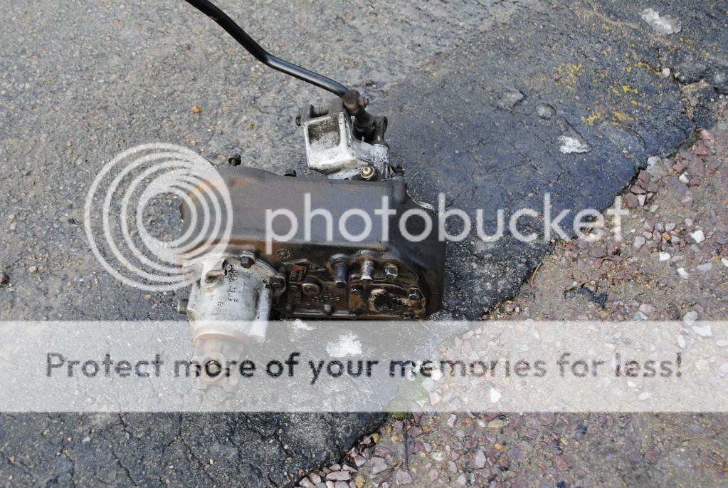

Iam starting to buld a flipped np231 into a flipped Dana300. I got some pics and will be posting them soon.
The goal is to keep the cost down by doing a lot of the work myself
Hopefully I can get the setup unto the jeep by the end of march

Ok here a http://i544.photobucket.com/albums/h...4/_DSC0003.jpg

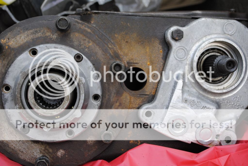

Here's a pic of new top off

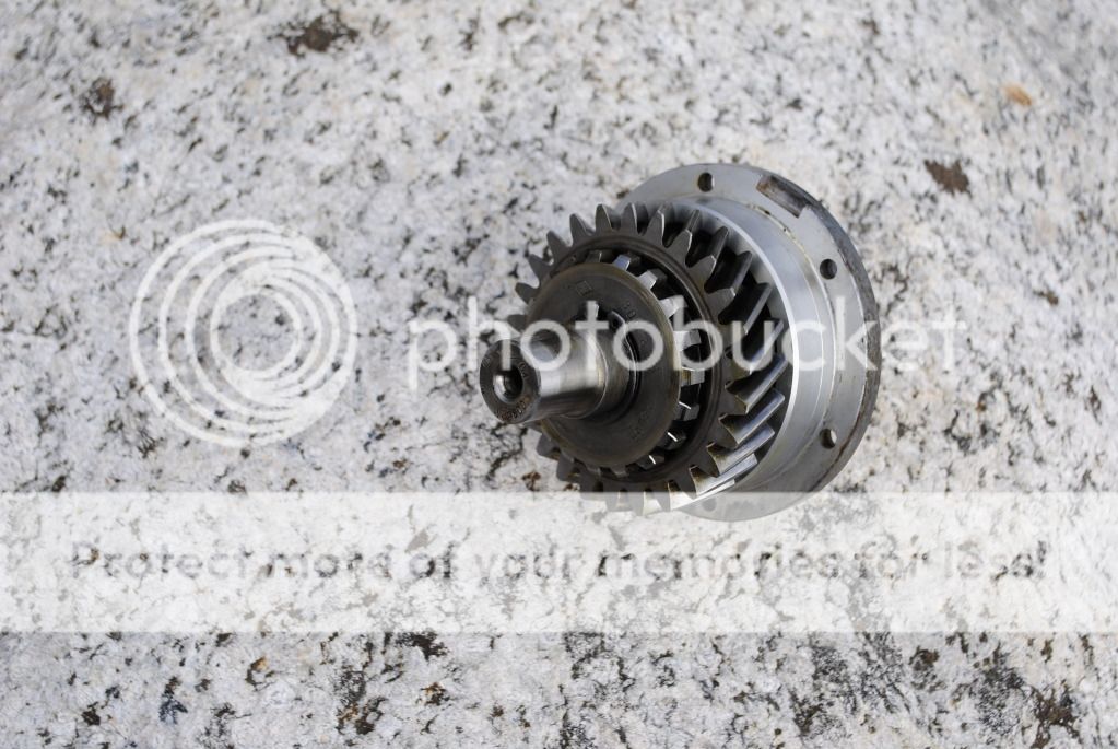

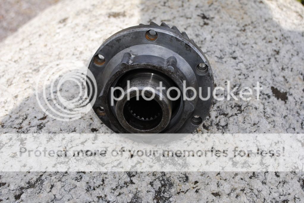

Next I pulled the intermediate shaft and gear

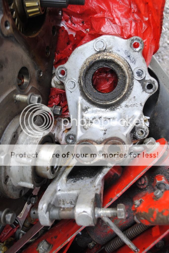

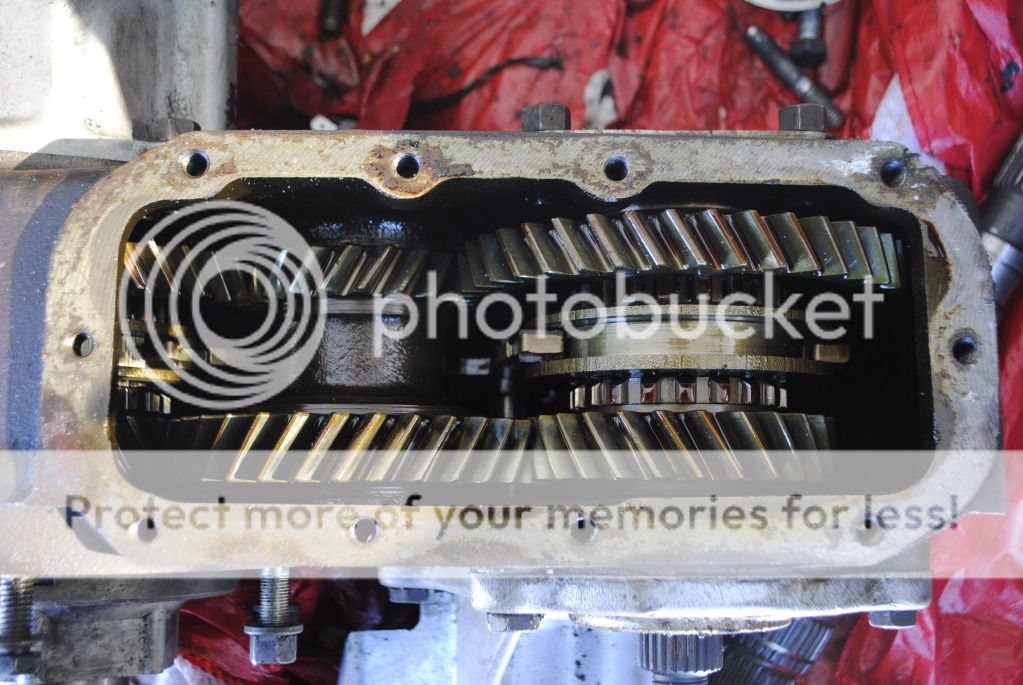

Next came the shift forks and shift rods
As you can see in the first photo ther is two Allen set screws that got to come out.

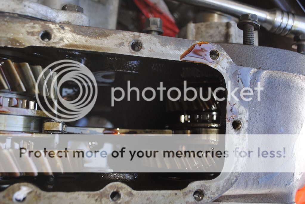

Next comes the shift rods. I put the F and B in neutral then rotated the B 90*and pulled the rod out then pulled the front rod

The shiftforks
And the front bearing cover
Next l cleaned, cut and drilled the front cover

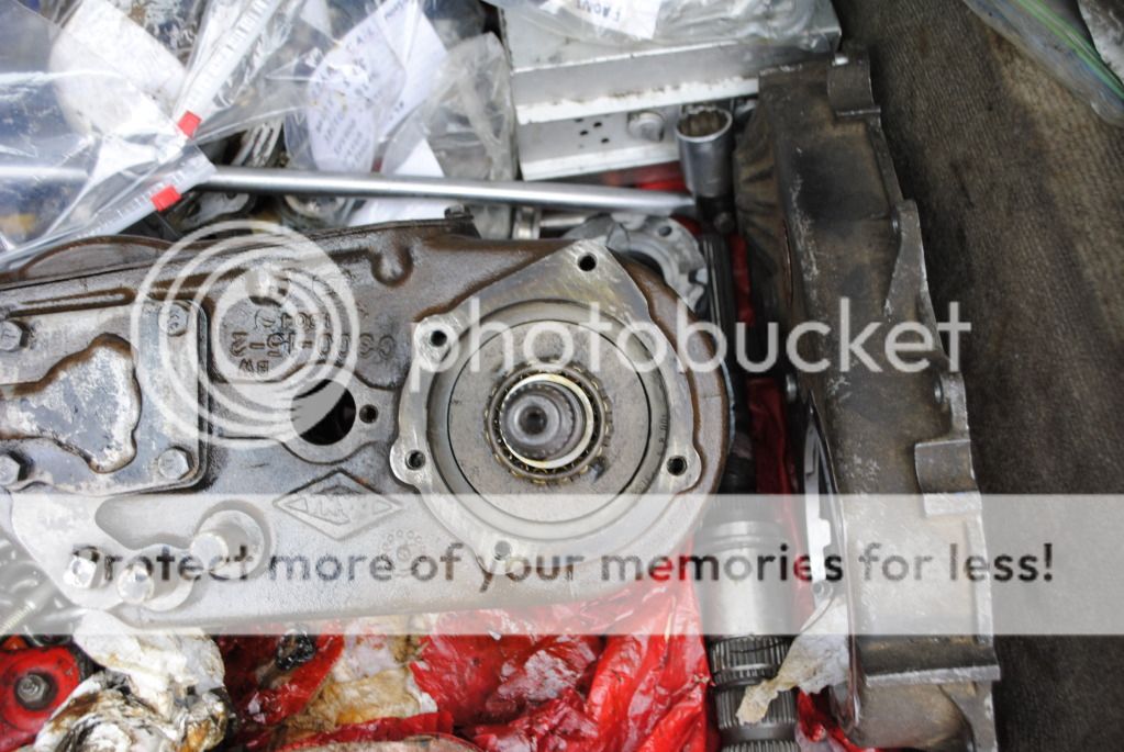

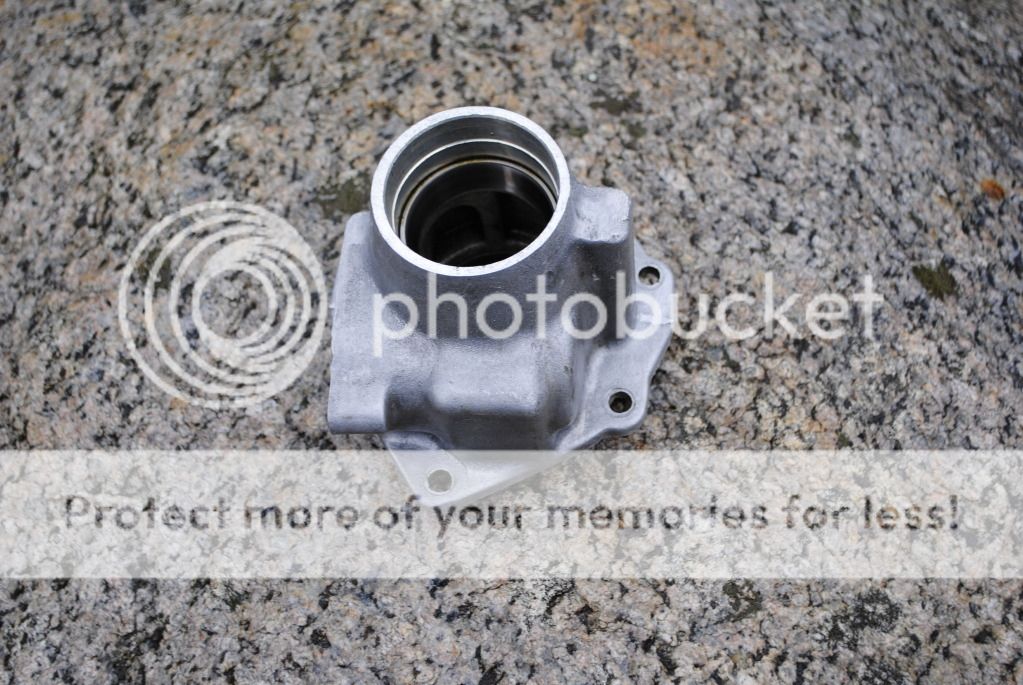

Next addressing the tale housing. It needs a 1/4" npt plug ware the old vent is
Housing off
For the plug I used a 7/16" drill and a 1/4" npt tap.
I also removed the old oil seal.
