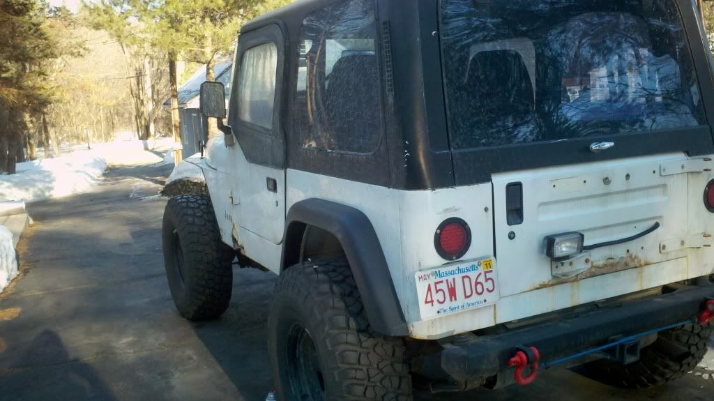

Metalcloak is pretty much the only option you have for tire coverage with the proposed amount of lift. They're legal with 35x12.50 15's:

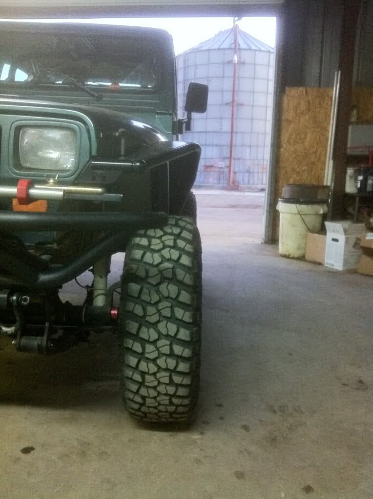

I have 2.5" leafs with 1" body, and flat fendered the front. Rear TJ flares open up the rear quite a bit ... However you will probably need to do more with just AAL's. Also stock TJ flares don't cover the tire completely.
One point often overlooked on the front fenders is the bottom corner where the rocker line meets the wheel opening. 35's get very close to this point on anything less than too-much-lift. This is why when I cut my front fenders I specifically went to where the front fenders meet the tub. You can see what I mean here:

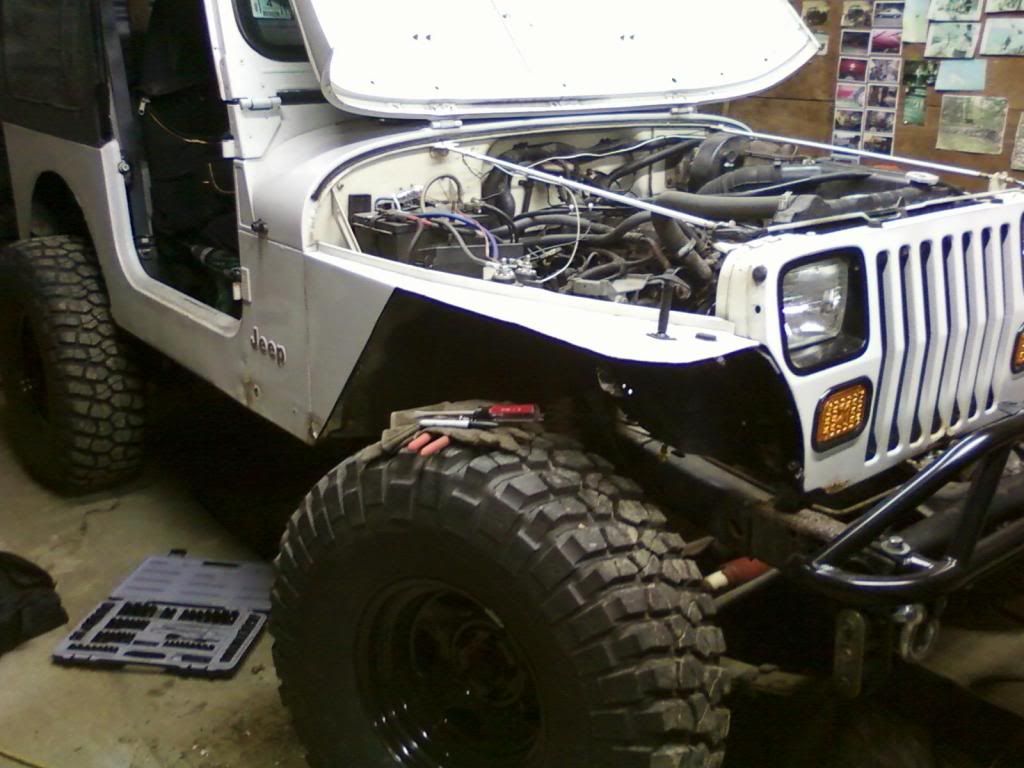

Same lift, same setup, stock front fender opening. You can see how close the fender is to the tire. Almost no up travel, and zero up travel with the wheel turned.
