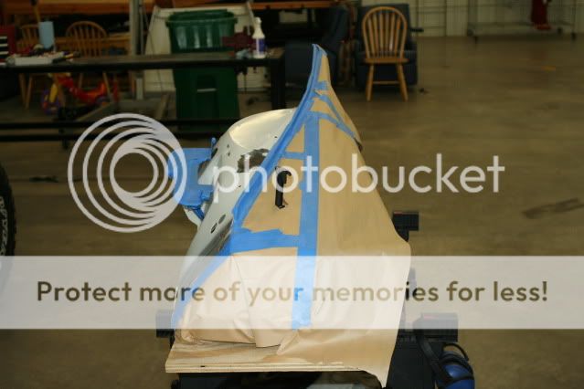

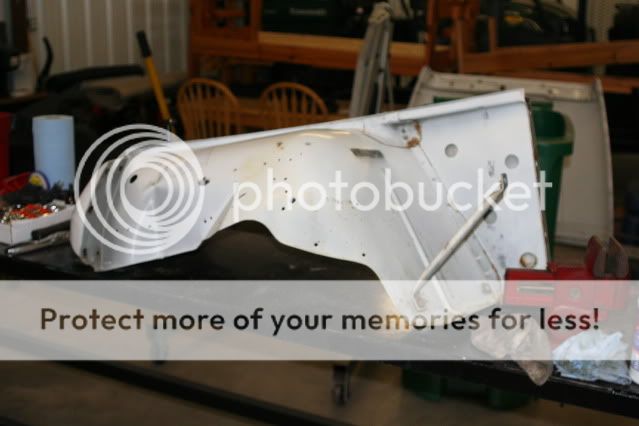

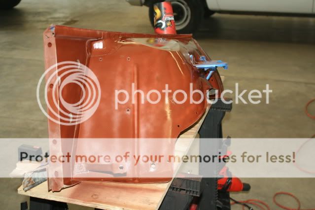

I decided today that I wanted to clean up the fenders a bit before putting them back on. Figured now was as good a time as any with them off. I pretty much just focused on the interior wheel wells for now and will take care of the rest later. After a good scrub down, I got a new coat of primer/paint on them.
Driver side. All in all, pretty decent shape to start with I guess.
I ended up using 3 light primer coats and 3 color coats followed by 2 or 3 clear. The passenger side didn't have anything different or exciting compared to the driver side, so I'll just throw a before/after pic in here.
I'll get these back on Sunday or Monday and get everything mounted back to them. Then I hope to get to tearing that old 35 out.

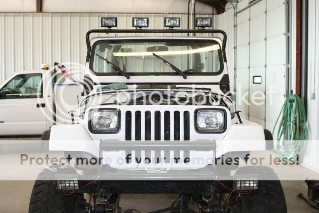

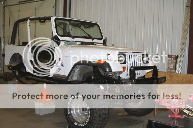

I was finally able to find some time over the last day or two to get some work done. I went ahead and got the fenders back on and everything under the hood is now where it is supposed to go. I'm happy to start working on the other projects I have been waiting to do. Ignore the wiring on those bumper lights, I wrapped those around the lights during the tear down. I will rewire all of my lights and add on crap later during this project.

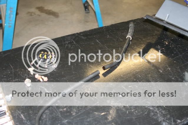

I did have one casualty....from what I read, I'll probably have to find this crankcase breather tube at the wonderful dealership.

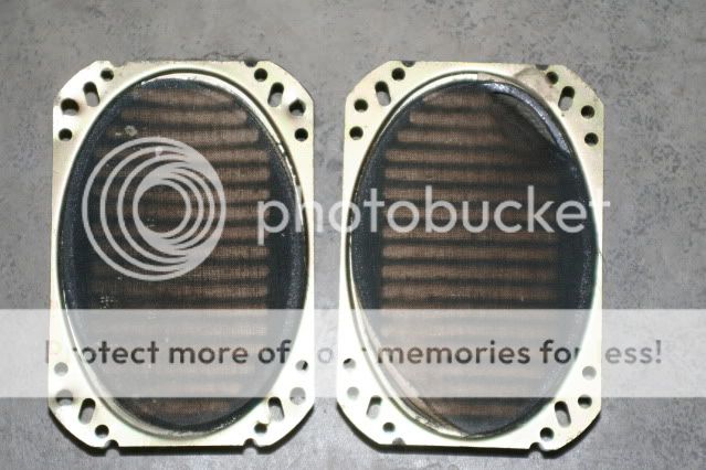

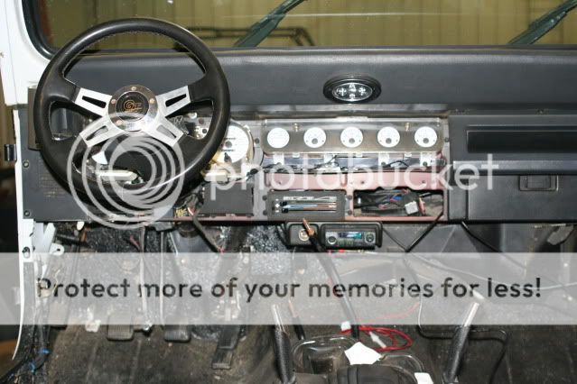

While I was finishing up under the hood, my brother from another mother, FirefighterJeep, was working on pulling the rat's nest of wiring from the dash. I got tired of the tons of wiring that much of which had no use.

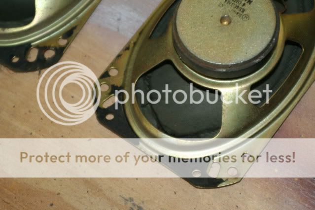

He also pulled the old factory speakers from behind the dash. I believe he told me they weren't even wired, but if they had been, they are so dry rotted and torn, they wouldn't have done anything.

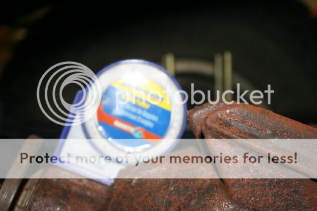

Today, we got started on the 8.8 install. I spent quite a bit of time carefully cutting the stock Ford spring perches off so I could try and reuse them. We got the D35 yanked pretty quick and were able to disconnect the e-brake cable intact so whoever I sell or give the axle to can have the option of using the stock cables and brake hardware.

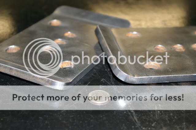

I was able to find the 8.8 spring plates on eBay for 19 bucks a set shipped. They were from a fabricator who is no longer going to make them and was clearing out his stock. Picked up a set for FirefighterJeep too for his installation just down the road. These plates are very beefy and very well made.
8.8 waiting for it's turn to be a part of something much cooler than the Exploder it came from.

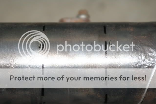

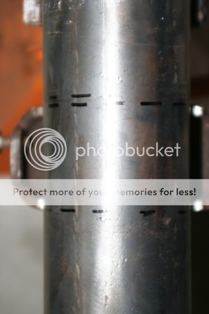

Before cutting the perches off, I made reference marks to transfer the original position around to the top side of the tubes for my SOA application. I then used a Dremel cutting wheel to lightly score the tubes as a reference to use when locating the perches for the YJ springs.

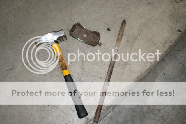

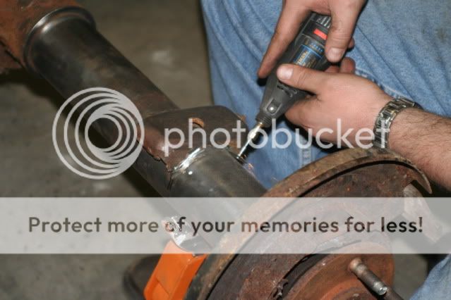

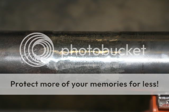

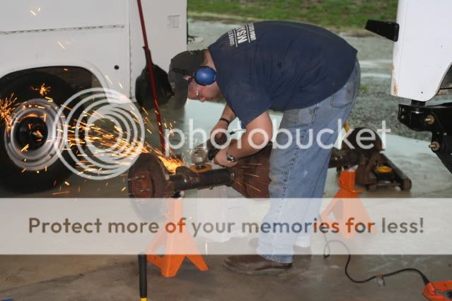

Time to do a little cutting. I started out just using a cutting wheel on a Dremel trying to be careful and only remove the weld on the perches, but that was taking TOO long. I changed the game plan to using a grinding wheel to remove most of the weld, then a 4.5" cutting wheel where I could. I then finished up with the Dremel cutting wheel and encouraged the remaining weld to break with a BFH and a steel rod to allow be to deliver the force to the underside of the perches.

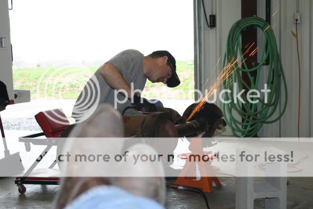

While I was working on the perches, FFJeep worked on cleaning up the new spring plates a bit. I ordered them a while back, so they had a little bit of surface rust on them. He used the quarter here to show the thickness of these very strong plates.
My view from the recliner while he finished up grinding the tubes smooth after removing the perches. Who says good help is hard to find?!?!?!?

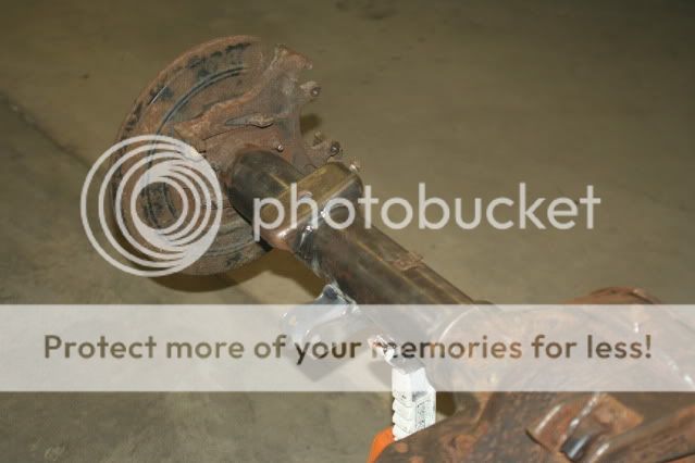

8.8 hanging in u-bolts waiting to position the perches. I used the reference marks I made earlier and found their center point. From that, I measured outward 5/8" and made a second mark. Using that mark as a new center point, I measured out 1.25" each way to create two new reference marks which the 2.5" wide perches would sit between and center the axle under the Jeep.
After getting the axle centered under the Jeep and snugging up the u-bolts (which will have to be swapped because they are too "deep" and we wouldn't have had enough thread to fully torque them to spec) I used a straight edge and a piece of string to aim the pinion nut directly at the TC rear output yoke nut. Then using an angle finder to determine that angle, I dropped the pinion 2 degrees and tacked the perches in that position. I also located my Currie lower shock mounts where I wanted them and tacked them as well. I placed those at 90 degrees to the bottom of the axle tube and then rotated them up approx. 5 degrees to keep them from acting like shovels in the mud/dirt, while still clearing the bottom of the axle tubes.
We pulled the 8.8 back out and cleaned it up a bit more and then loaded it into my truck. I'll drop it by the welding shop in the morning to have the axle tubes welded to the diff housing and the welds on the perches and shock mounts finished while he is at it. I didn't trust myself to properly weld the tubes to the housing. I'll go ahead and tack the brake line tabs and anything else after getting it back and setting it up.

For your speakers in the dash to prevent mud and debris from getting into them put a fine mesh cloth over the face of the speaker. You'll be glad you did. Great work!
That's a good idea! I don't know what I'll put back in there yet. I haven't looked around to see what is available in that weird size. Any ideas? I wonder if I could find some marine speakers in a size that would work in there?
I'm sure it's pretty low on your Jeep to-do list, but I read a post somewhere, I think it was on here, about someone using some marine speakers in place of those in-dash kickers a while back. And I know I keep folding the corner in Quadratec's catalog on a set of replacements... Hope that helps.

Thanks Slashway! I'm trying to get it close to right in most cases. Are the speakers you've been looking at in QTec marine grade? I'll have to go take a look at the catalog and see what they've got. I'm focused on main components right now, but don't mind picking up other items here and there in the process. Thanks for taking time to read my thread!
