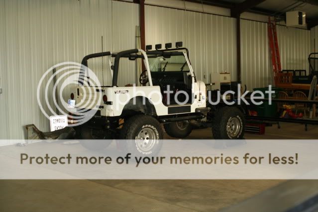

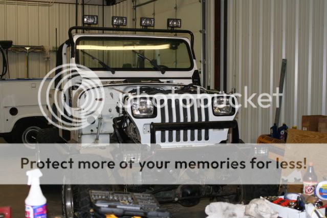

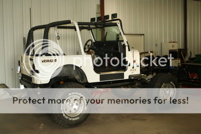

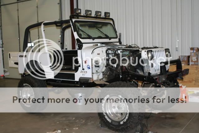

Finally found some time to get back to work on the Heep. Not much time, but time all the same. With the help of a couple of great friends, we got the tub set back on and mounted. The next couple of days will be devoted to getting everything hooked back up, filled, bled, mounted, and then on to getting the 8.8 and high steer done. Here's a couple of pics of what got done this afternoon. I used the Daystar body mounts with 1" lift. Despite removing the POs 3" BL, swapping the old flat springs for the 2" BDS packs got me and inch or two more lift. In these pics, the new springs still have not been compressed or flexed yet, so I'm sure there will be a bit of a difference once they settle in a bit.
Thanks again to FirefighterJeep and Banks for the help! Hope to get much more done over the next few days and will post up plenty of pics of the progress. Thanks again for checking out this looooong project.

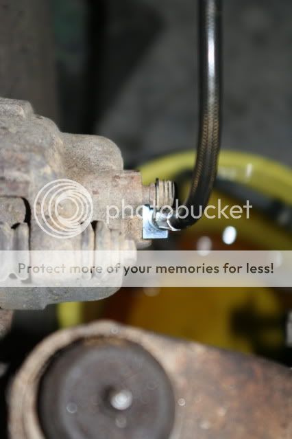

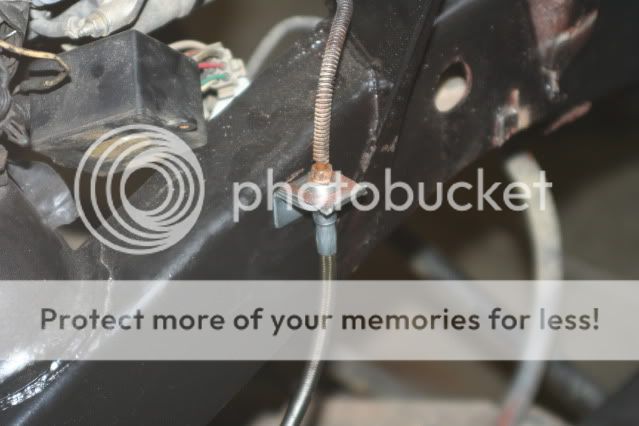

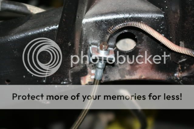

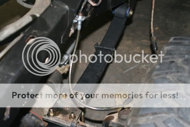

The last item of business was to get the extended stainless brake lines on the front. I had to cut away the previous mounts that the PO had moved and welded to the frame. A small Dremel cutting wheel and a BFH had those off in ten or fifteen seconds. Nothing special here, pretty straight forward. I used the same banjo bolts and added new copper crush washers to each caliper and then mounted the new hardware where I liked it on the frame. I'll check the placement when I can finally flex/stuff to see how they react. I was able to get it done without losing too much of the old fluid. I'll flush out the rest when I bleed the system.
Driver side mount. This was just above the old mount done by the PO. I checked for interference with the shock and it has a ton of clearance.
Driver side "droop"
Passenger side mount
That was about it for today. Tomorrow I hope to get the fenders back on and everything else under the hood routed and hooked up. Then it will be on to the 8.8 install. Thanks for taking time to have a look and as always, any comments or questions are welcome! Especially if anyone notices anything I screwed up on!
