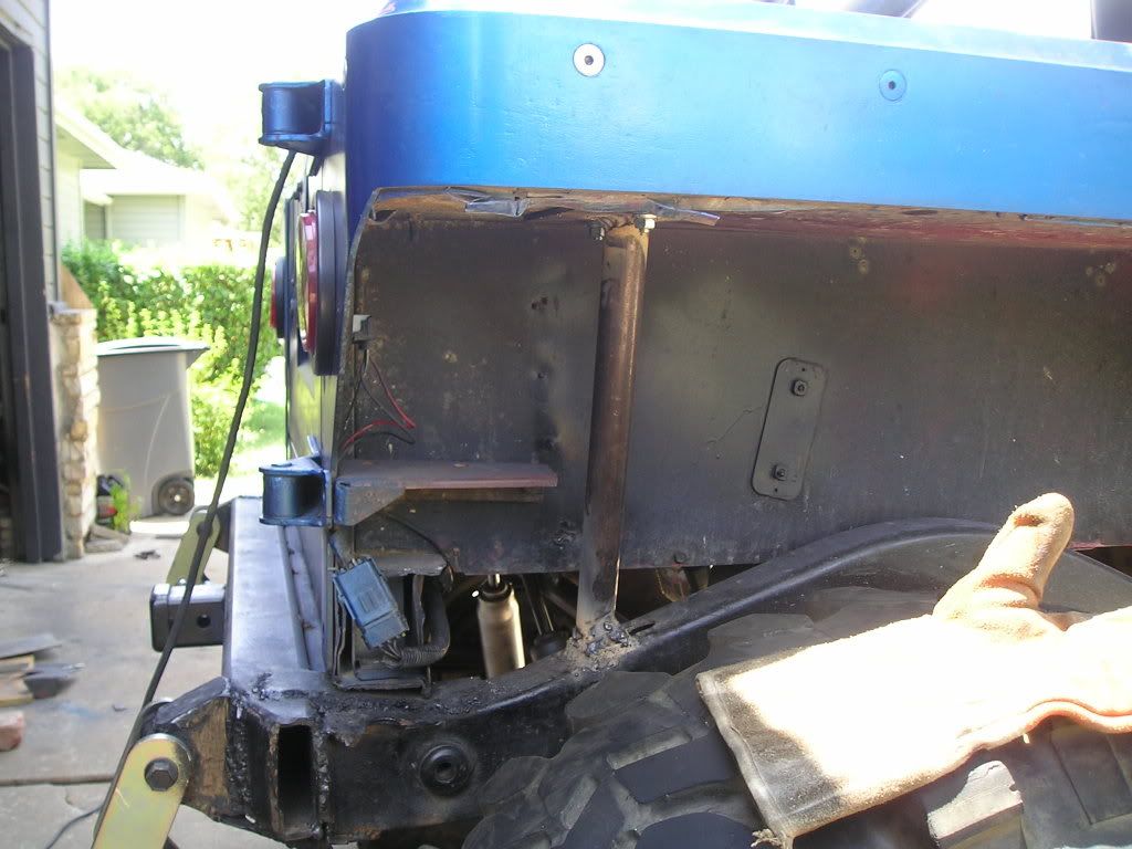

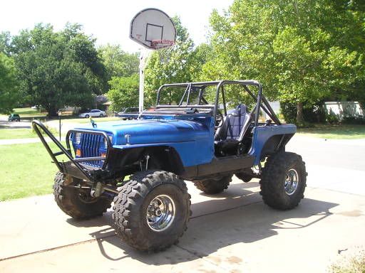

best way to stretch is to make a rear crossmember with mounts for the shackles, then new front mounts for the leafs, and move them back the same distance as your rear mounts, thats how i did mine, every simple. ohh and i used the stock lengh BDS 2" SOA leafs
here is mine, u can see where the stock mount is, and what i added, then i just moved the front mounts the same diststance as the old rear center mount and new rear center mount.
here is a pic of the rear during some finish work
and here u can see the added WB, about 9" added
if u have any questions let me know
91 YJ 4.0/ax15 Stretch to 102" D44s 5.38s Detroits/Hi Steer/38.5"TSLs/Custom full cage/ Corbeau seats/Crow Harnesses/PSC comp corners.
