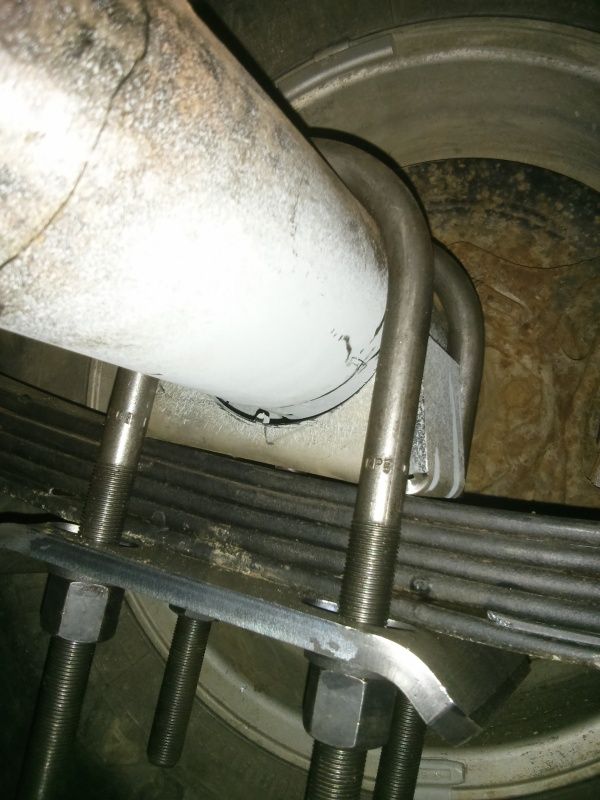

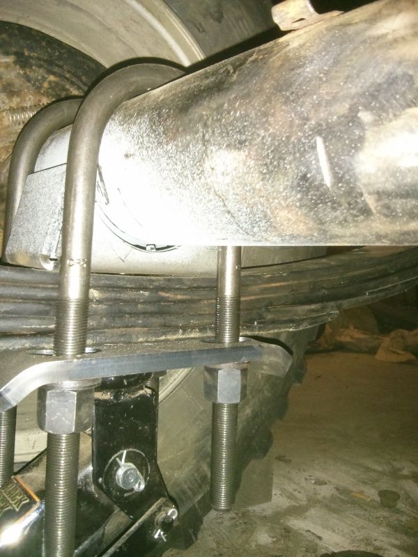

Thought I would add this, if you happen to get the shorter sua style perches from ruffstuff, you actually have to leave the nubbies on! kind of a bummer, I ground 1 set off before even checking fit, luckily they sent me a new one since the website clearly says to chop them for 8.8.
so that gap + the meat missing on my tube from rust makes quite the gap!
If she ends up squatting in the rear I already have 1" booms, and might just go with 5/8 or 3/4 on the front and sell off the front 1" set

mine are made up by forum member BESRK, they are 3/8 thick and nice. I will trade if the rear sits too low. gimme a week or 2
And no, those are special SUA perches that are 5" long instead of the 8" ones that come in the kit. the 8" ones are better suited for soa, if you read back Feetwet cut his down to around 5"
Look back at post 79 for clarification

I still dont see the confusion. the SUA (spring under axle) perches are shorter in length, thats what I ordered. the kit comes standard with SOA and they are longer
-April '14- YJoTM- June '15
Way to go all referencey there, Goob!
That looks like your mockup stage. Did you get things sitting all square finally?
Hopefully you managed to fill that gap with a nice bead or two when you burned em in for good.
That is how its sitting right now, I ordered the driveshaft the other day, and wanted to wait till its here and hook it up and set everything perfect, instead of eyeballing the pinion. Anal I know I might get a wild hair and go out there with a square and tack it in. I wont be doing the full welding (read: Harbor frieght 90 amp flux core and poor skills )
