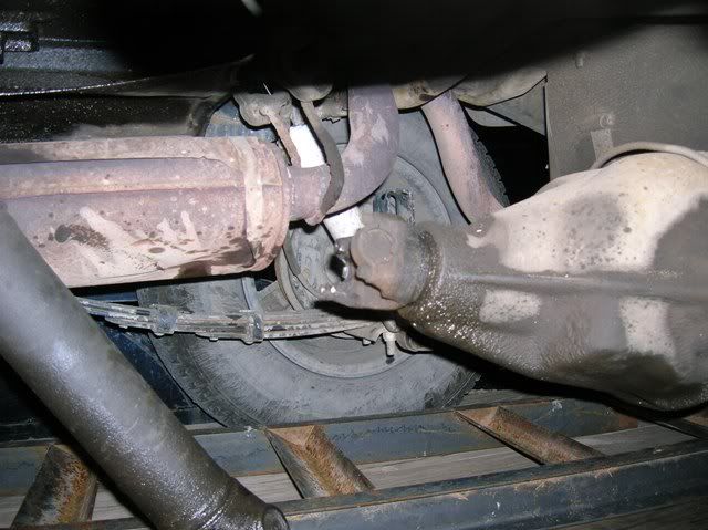

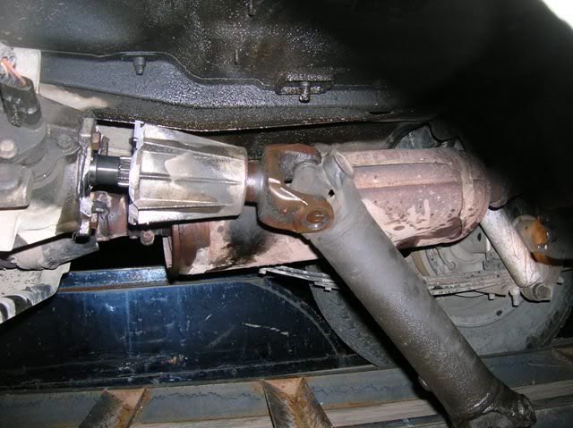

The heeps been vibrating a lot lately under acceleration. Stupid me ignored it. Today while driving down the road it started vibrating so I pushed in the clutch and then let it out, hoping that it would ease the vibration like it has in the past. Instead I got a load POW and then nothing. Coasting to the side of the road I stopped, looked under it and found this:
I did not try and drive it, knowing that I leeked most of the fluid out of the t-case, it was winched onto a flatbed where it currently is sitting.
So, on to the question, obviously my rear housing is a gonner, as well as my pinion yoke, am I going to need to get the transfer case checked out? I’ve been wanting to put a SYE on for a while and obviously this is a perfect excuse to do that since the housing will get replaced, but how can I make sure the t-case is o.k. without spending $$$$$ having a shop look at it? I've also been thinking about an 8.8, God I wish I had more money.
Also, does anyone have any suggestions as what else I may need to look out for?

Damn bro thats no good. I hope it all works out for ya. I would look into getting a SYE while its broken. That way in case you managed to bend the output shaft in the transfer case, it wont be an issue when you get it back together. If not, then I would check the shaft in your transfer case at the least. Throw some fluid in it, and put it in 2 wheel with the shaft off to see if its spinning out of plumb. Also, you may want to check the tub, to make sure you didnt put a hole in the bottom, or chip the undercoating from the driveshaft flailing around.

I tend to agree with Ultimate on that. It's not normal for a stock height t.c. to just let loose it's tail end like that unless you were out on the rocks and came down on something. Judging by the photo,it looks like the joint broke at sometime and eventually took out the yoke section. I think by ignoring it it exploded and wobbled that tail section loose . Excessive vibration can do some weird things. Thing you'd be ok to open it up ,check it out for fragments or any other damage in there ,then replace the tail shaft ,seal and bearing. If you're planning a big lift in the near future, if might be wise to go with an sye kit now. Your call!

Sorry to hear/see, that blows. As for your pinion, its kinda hard to tell in the pic, but it looks fine to me. It looks like you just broke the cap off it (the way its supposed to fail)
