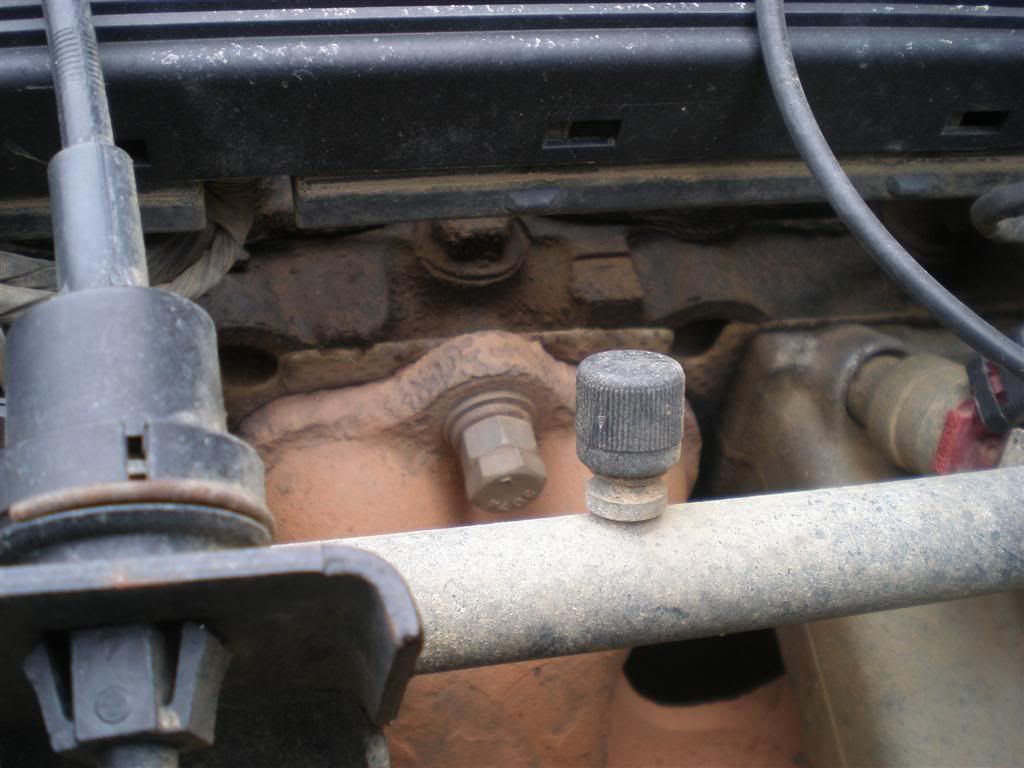

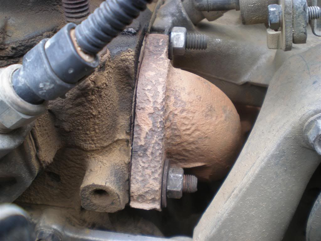

Heres some pictures of the gasket tahts on it right now...

Posts: 543
thats what mine looks like also, and i have a 94 2.5. Looks like it's a gasket to me but im not sure i haven't taken that apart yet

Posts: 3,652
It is a gasket.

Posts: 3,905
Originally Posted by Switch1625
It is a gasket.
And a pretty badly worn out one too judging by the pics. No worries dude, we'll get it swapped out Thursday

post #40 of 40 Old 04-12-2007, 04:07 PM Thread Starter
EJames1226
EJames1226's Avatar
Join Date: Jul 2005
Location: Escondido
Posts: 3,652
Alright!
We changed out the old gasket, wich was poop, and put the new one in, replaced my missing bolts, and my jeep sounds awesome now. Its so quiet, im not used to it being so quiet. New milestone: My spedo read 70mph (So i was really goin about 75) I didnt even realize it, was goin down a hill and noticed my spedo, and slowd down alittle.
So anyways...
Yes on the gasket
No on the draining the coolant on my 2.5
And it fixed my problems.
Im so happy.
