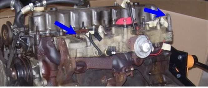

Posts: 318
Originally Posted by 92 Green YJ
ok, jeepdrvr, tell me why he has to drain the coolant to remove the intake manifold? there is NO coolant running thru the manifold or anywhere near it for that matter.
I have coolant coming out of my intake manifold from these tubes.
jim
