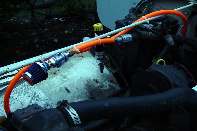

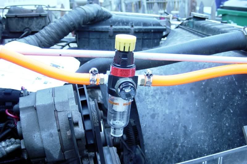

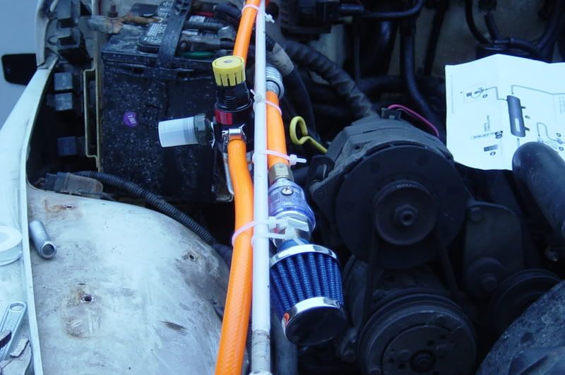

I did my OBA project today. Installed the hoses and tank but not the wireing
heres the factory hose to the air line
[IMG][/IMG]
Air line through factory AC firewall opening
[IMG][/IMG]
Making the cut for the seperator
[IMG][/IMG]
Seperator installed with pressure regulator
[IMG][/IMG]
intake filter, seperator mounted ,inline oiler and pressure switch
[IMG][/IMG]
another view
[IMG][/IMG]
Rear hole drilled for quick connector
[IMG][/IMG]
Rear air line installed to tank
[IMG][/IMG]
Front tempoary connection
[IMG][/IMG]
Wired it up with aligator clips today to try it.
The air line to the factory output connection kept blowing off due to a bad hose clamp.
Im going to the hardware store tomorrow for a replacement
Over all this really wasent a hard project, just time consueming.
The hardest part was mounting the tank and cutting away the plastic under the pass side rear wheel well to access the nuts for tightening
Still to come is spliceing the air line for a dash mount guage and power switch
And a preview for the next project... I aquired some diamond plate and metal stud thats used for building, this will be my overhead console
OBA , light switches , speakers and a lock box are in the works
