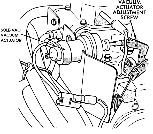

don't know if any of these willw ork but i pulled them off alldata
if you know specifically what you need i can try to find a schematic or diagram for you.
