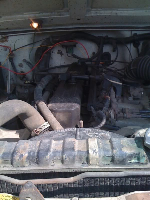

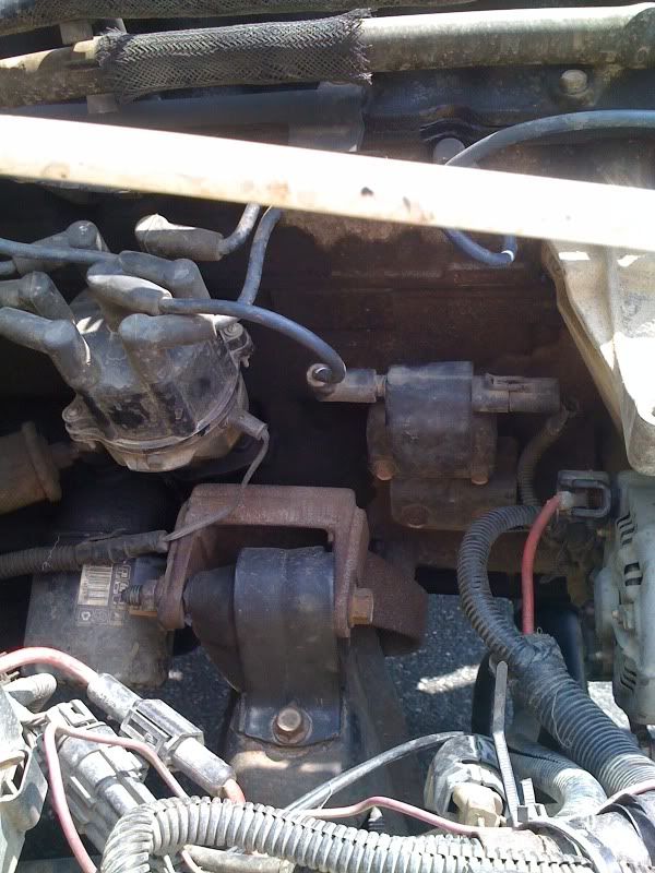

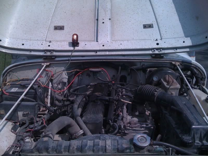

My engine, tranny, exhuast is all shifted. jeep vibrates alot "obviously" i changed the motor mounts and that dint fix it
i looked at this and just started laughing cuz i dint know what else to do lol please help if you can

you need new motor mounts. Replace both of them and the trans mount while you're at it.

Have you checked the tranny mount? Looks like it must have broke to be that far off.

When you change your tranny mount, check the bracket that mounts to the trans and t/c, a lot of them crack and or break, that could be your problem, also check the trans torque bolt and bushings, they break also, looks like these 2 things are likely your problem and could have caused your motor mounts to go.....
