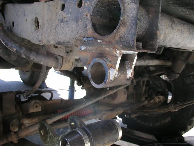

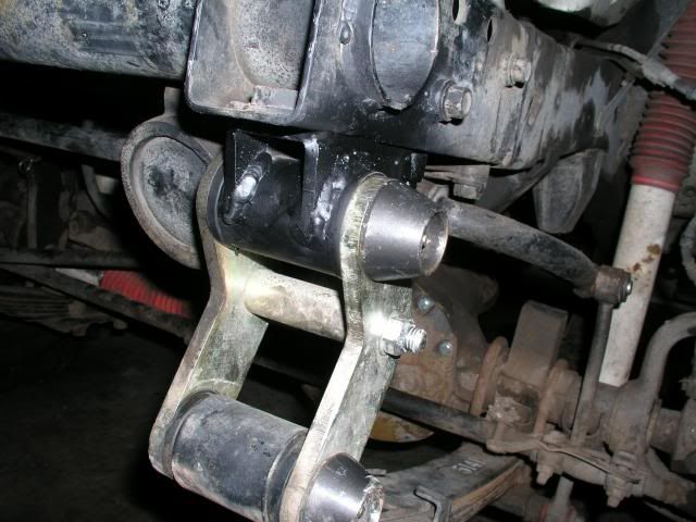

Yes, the stock mounts are weak. Ask squishy, he just broke one. They take a lot of side torque. I'm will to bet those lowered mounts are for show. Those pickups probably never leave the mall.
What you need is something like this:
http://www.ruffstuffspecialties.com/catalog/WBHGR.html
I broke one once in a mud hole. Here are some pics of them now.
