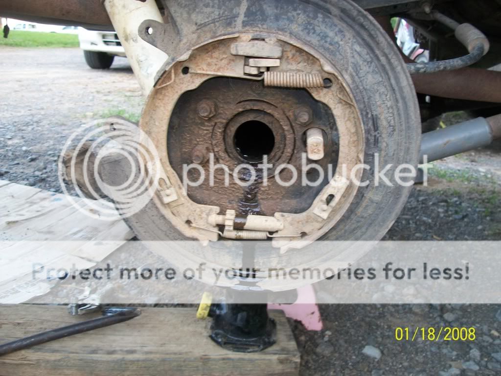

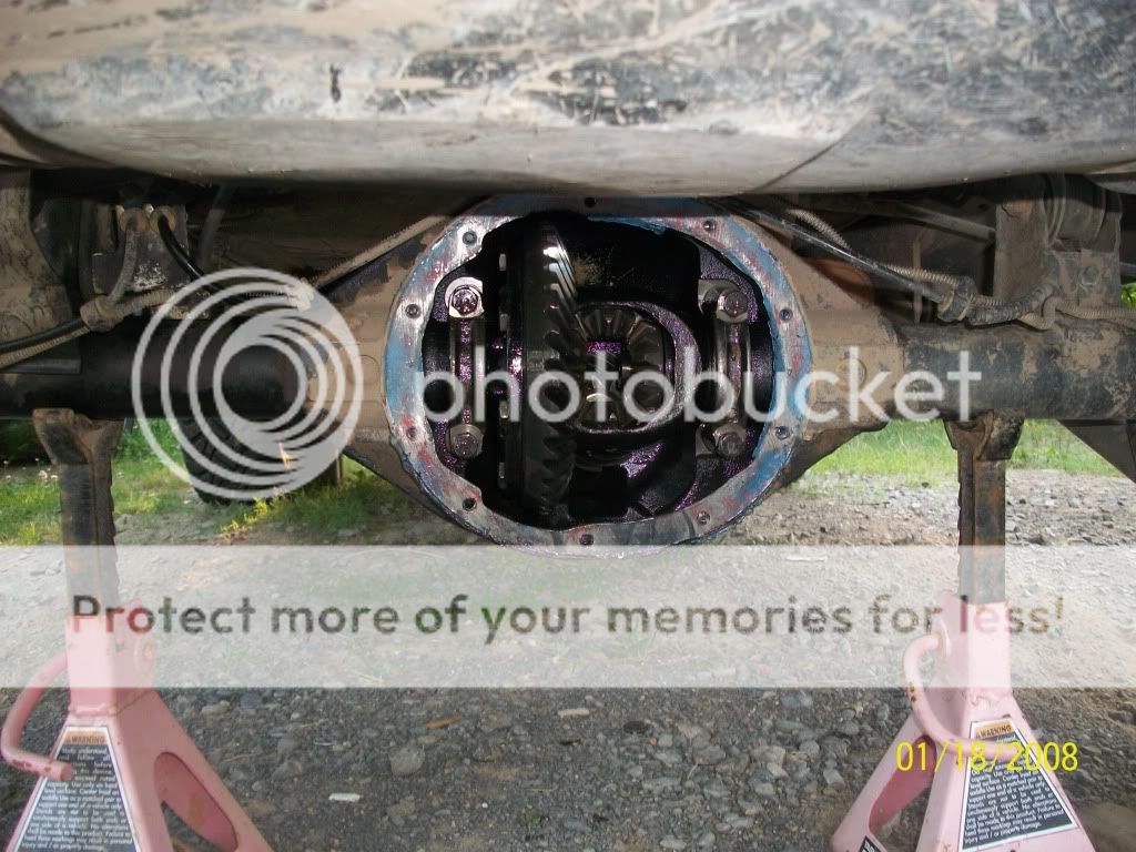

to change the axle bearing you just jack it up, remove diff cover, remove the little bolt on the carrier, push the pin through, the spider gears will come out. remove the wheels, push the axles in. then inside the differential there are C clips that hold the axles in where the other 2 spider gears are, remove them. then slide axles out. then you will see the bearings. remove them and replace them.
right behind this seal is the bearing
