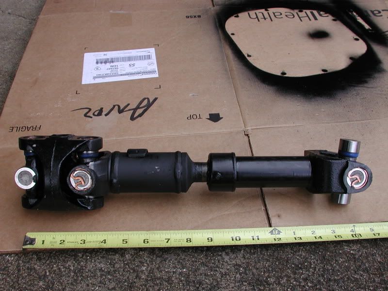

2 inch BDS susp lift, 5/8 boom shackles, SYE and a rear Dana 44HD. Measurement as shown with slip yoke not completely collapsed. Mine is 16 inches from center of cap to center of cap in this photo. It is a cut down and balanced XJ front shaft.
You're likely in the ballpark, but you should measure yoke to yoke with it on all fours , then consider at this height the slip yoke should be open 1-1 1/4 inches and go from there. This measurement is going to depend on a lot of variables so don't be surprised if yours is different, it depends a great deal on your particular setup.
