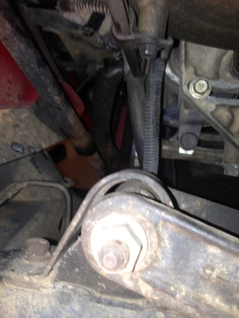

Been hearing a clunk occasionally when changing gears so started looking at some of the mount points of the engine and tranny...
So I was checking on the motor mounts yesterday and noticed that the driver side does have a good gap on top maybe about 4-5mm between the rubber and the metal "cap". So I got to thinking if it is normal. I checked on the passenger side and the rubber there is pretty snug inside the housing. Didn't know if the driver side is like that for a reason or if it needs replacing. Doesn't appear torn up or anything, just a gap is all..
Anyone have an idea about whether the stock mounts are supposed to have a gap between the top part of the rubber and the metal piece that goes over it?
Thanks in advance guys!!

post #2 of 16 Old 05-14-2013, 10:02 AM
bogleparsons
Location: fayetteville
Posts: 1,960
There should be no gap.
If it's not supposed to move and does use duct tape.
If it's supposed to move and doesn't use WD40

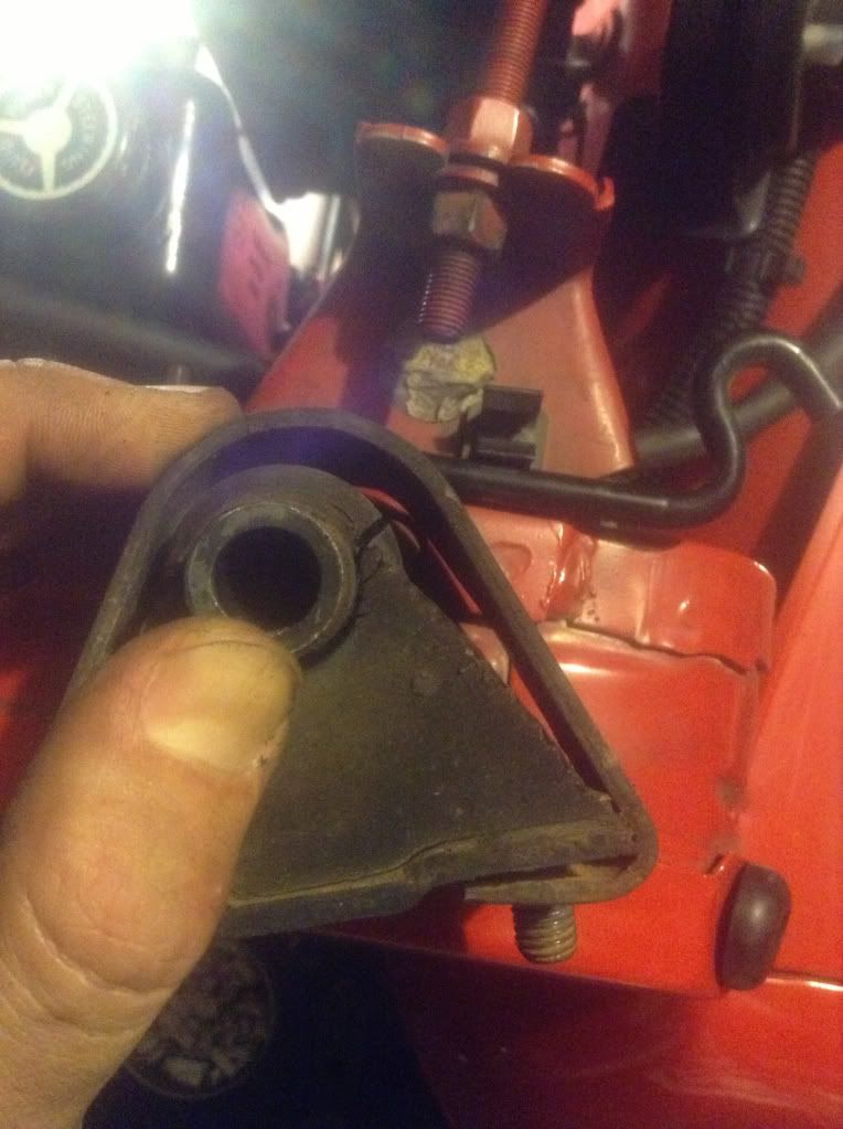

post #4 of 16 Old 05-14-2013, 11:00 AM Thread Starter
atldude
Join Date: Jan 2013
Location: Atlanta
Posts: 341
Thanks guys!
This is what it looks like. Was able to run a 5mm metal rod through the top. The passenger looks good. Guess its time to replace it.

Lol sure did. Got the crown kit with both sides and the tranny mount. The pass side looks like a ***** to get to but i am sure one day it will be time for that also but if i am not lazy i might take care of it too and have a piece of mind.
The tranny mont looked a little loose to me also after pushing up on the transfer case so i'll take care of that also while i am at it.
atldude is offline

Didn't find the specs on the forum so here's the fsm values:
The bracket bolt and nut to 38ft/lbs
The through bolt to 51ft/lbs.
All done with this one..debating if i should start the tranny mount or just do it in the am ..gotten lazy lately
