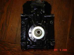

Does this look like a york to you?
I can't really tell but I think it is.
Thanks for any help

Any ideas? Theres no id tag on it just some numbers, on the top are 12-5512 with g-70 under it and on the back right side is 012-21713.
Thanks

It looks like one to me, kinda like one I saw about a week ago.

Looks like one, but where is the inlet/outlet they should be on top but they aren't ?

What exactly does a york do?

Looks like a york with the screw fittings not the flanges. They are a little harder make work.

Its technically an air conditioning compressor but its popular as an air compressor for on board air.

Self oiled A/C Comprssor you convert to an on board air compressor.
X2
here are some vids... this is very impressive to me anyway, keeps up with my air chisel AND my Impact, if I turned it off idle I am sure the VERY minimal drop off I see would go away. I have the medium sized York, the only thing I haven't been able to run that I have tried is my 3" air cut-off wheel. I was able to remove all 8 - 1" lug nuts off my motorhome without waiting for rebuild of air using that impact.
