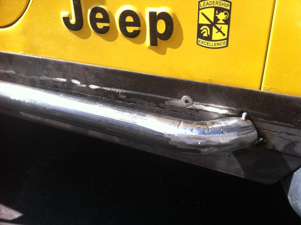

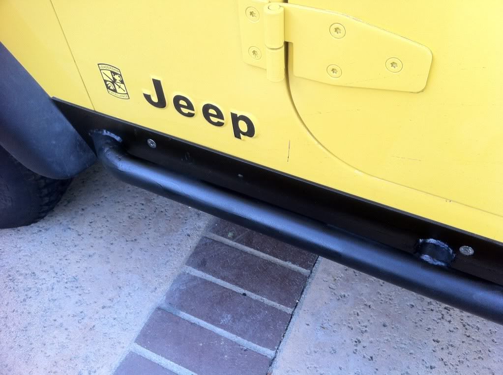

Okay, wait a minute, are you talking about rockers as in body panels or rock sliders?
XJ93 is offline
post #19 of 27 Old 08-15-2013, 03:23 PM Thread Starter
BIGJoe29
Location: Yorba Linda
Posts: 191
sliders

Well those are rock sliders not rockers, and you can make them fit.
XJ93 is offline
post #21 of 27 Old 08-15-2013, 03:53 PM
Anticanman
RIP one good jeeper
Anticanman's Avatar
Location: Ripon
Posts: 20,368
If you cut around the body mounts and use them as a big piece of angle iron, they'll work. The lateral force is pressing into the tub so the extra mounts on the body mounts aren't necessary.

Anti, I'm not quite sure what you mean by angle iron? Did you mean cutting flush around the body mounts so that the rock slider will fit to the tub?

Basically turning the TJ slider into a piece of angle iron is the easy way to get it to fit correctly.

[QUOTE=Luuca;15800602]3"x3"x10.5' 3/16" angle iron : $40
2"x5' 3/16" flat stock: $14
2" diameter by 3/16" x10.5' tube: $15
10 stainless steel bolts, washers, nuts: $8
Textured black rattle can paint: $ 7.00
Having a good friend who is the fabrication manager at your work and a fellow jeeper: Priceless
Posted via my pretentious iPhone.[/QUOTE
This is much cheaper. I will be going this route. Thanks guys
