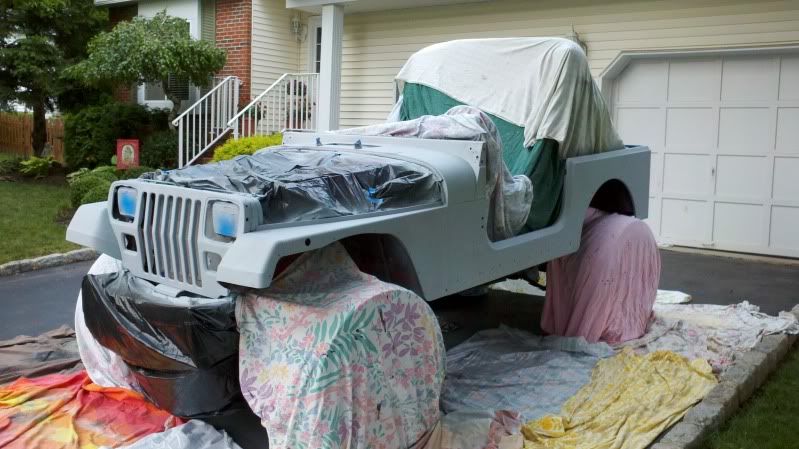

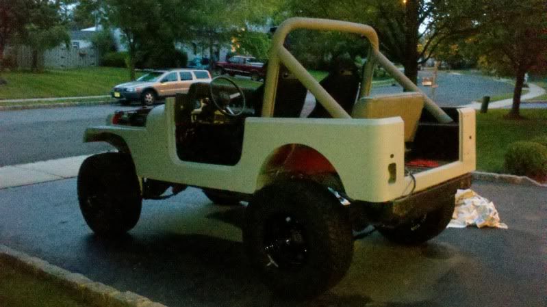

Great information guys! And seeing the prep pics helps me figure out the stuff I am forgetting.
