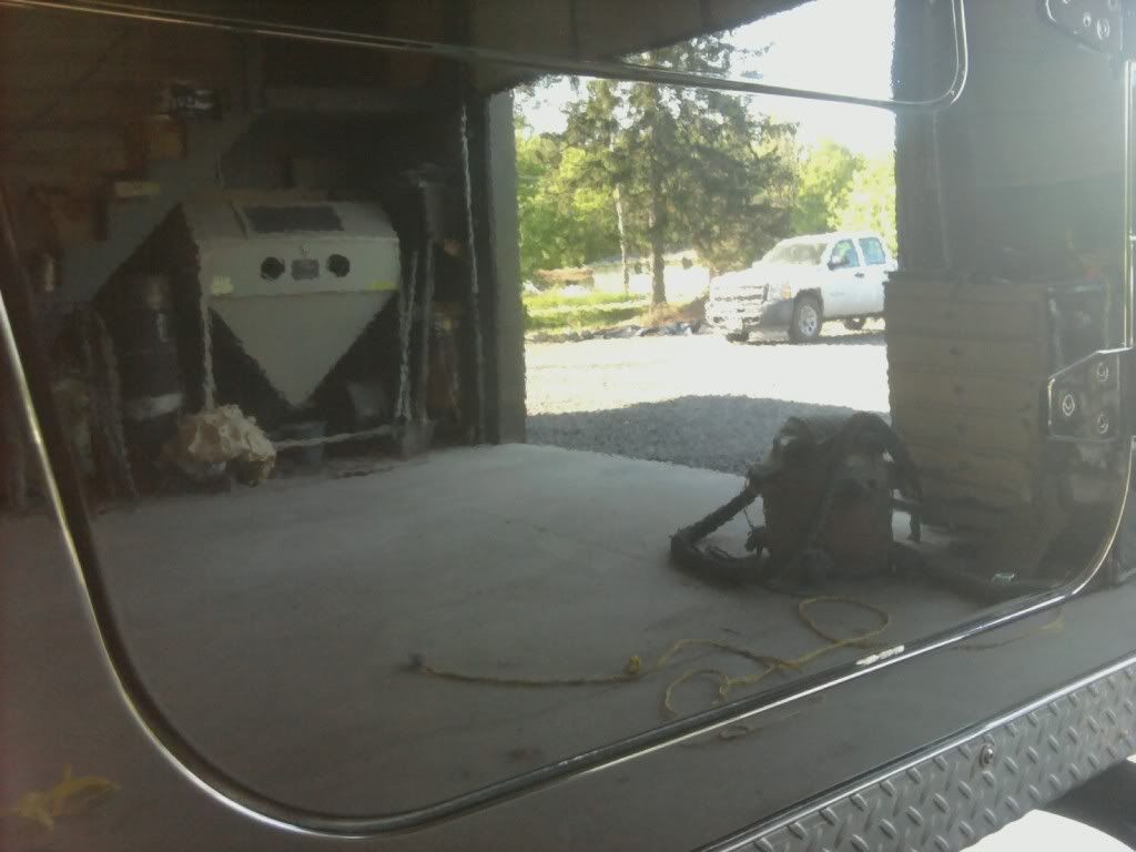

HA HA!!! I am laughing at myself here. I looked at your picture and thought, "What the heck is this guy talking about? He posted a picture of an empty garage!" Then I realized that I was looking at the sheen of your door. Great work!
Originally Posted by hesserdude07 View Post
and if you wanna keep it black, then take your sweet time and prep it right. Sand every inch of it, and then double check all your corners. And as others stated, if its bolted on then remove it!!
Here is a black jeep that i did about 2 months ago(give or take). This is the passenger side door...

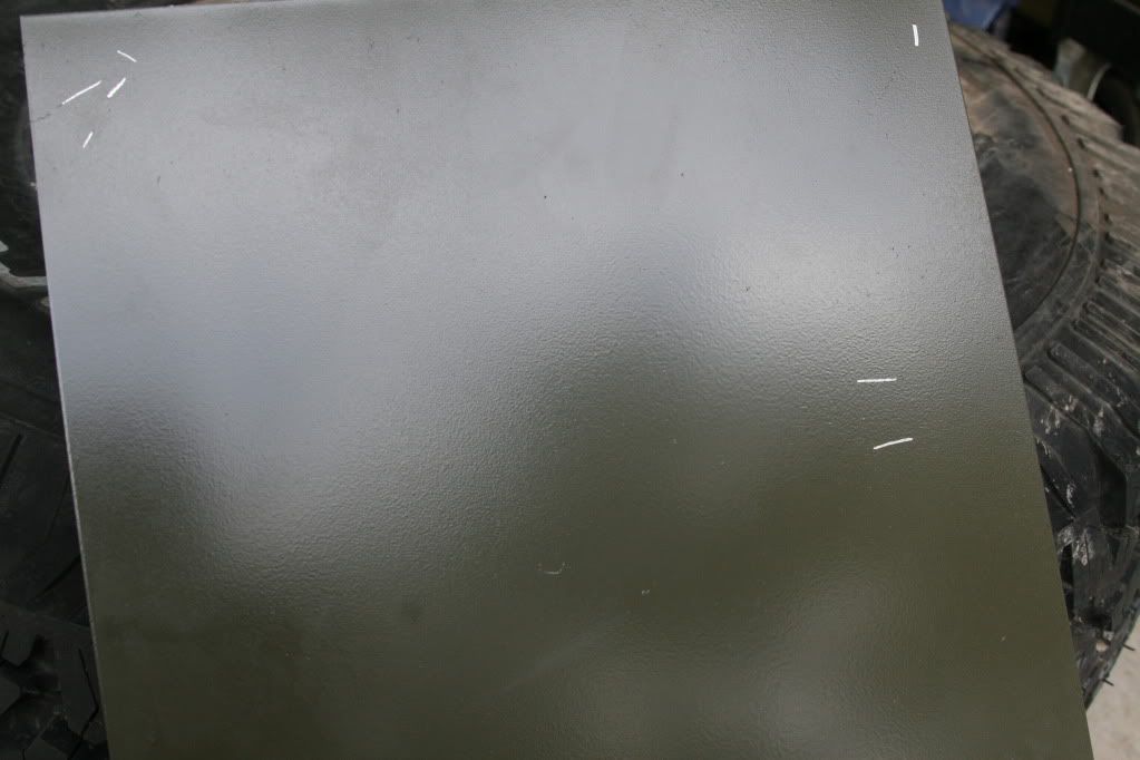

Posts: 67
I've painted before, not professional or even close to it and mainly assisted my grandfather who was before he finally retired a 3rd time. That was painting aircraft with Imron, fun stuff Last month I picked up a 95 YJ that was factory black and had a flat black rattle can job over the peeling clear. Couple that with the peeling bed liner and I knew I had some work ahead of me. I stripped the liner and decided soon after that I would paint it. I began to strip the paint trying to keep as much of the factory undercoating on as possible.
I set up a spray area in the garage using my 30 inch fan and cut plywood to create a base with the garage door raised the same height. It pulls filtered air out of the house using a few air filters and exhausts through the hole cut for the fan. This was set up at this point just to test it prior to final paint. Since I know this jeep is going to get torn up I wanted to go as cheap and easy, while getting a decent 20/20 paint job as possible and decided to give Rustoleum a shot. I didn't want to deal with any fresh air systems so I tried to stay away from auto body paints.
Did some minor dent correction if they were easy to get to. I went ahead and sprayed rusty metal primer since I already had it for my paint mix. All parts were sprayed with Rustoleum filler primer, 3 coats, and I started wet sanding. The color I plan to use was borrowed from a suggestion by another board member, Hunter Green mixed with Rusty metal primer and thinned with mineral spirits. I picked up the $34.99 model HVLP from Harbor Freight used a 20% coupon and gave it a shot based on the comments listed. I've sprayed with a few sharpes and binks guns, again not an expert but this gun when adjusted shot well.
Minus the materials that I already had, I've spent $30 for the gun, $30 on paint, $44 in filler primer and put in a decent amount of labor. I bought the jeep to have a project and knew I was getting into work when I did so. I'm also not overly concerned about the elements as the jeep will be in a garage when not getting torn up.
My wife is ready to get her garage back and I hope she doesn't notice the 30 inch circle spot that I managed to spill Herculiner on I only wish I would have determined I was going to paint prior to rolling in a new liner.
You can see some pics here if interested.
http://photobucket.com/Jeep95
Paint should go on this week, this was just a quick color test over a piece of sheet metal I had laying around after my floor pan repair.
sirhc76 is offline

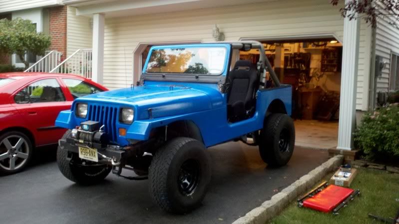

I re-painted my YJ a couple of months ago. I allotted two days for prep, one day for painting, and 3-4 more to allow it dry time (I dont have an oven).
The first day was stripping the entire interior out, as I was doing inside and out. It didnt take me the whole day to do this, so I started sanding the interior/exterior toward the end of day one. ALL of day two was used to finish up the sanding. It is imperative that you get all the clear coat off of the jeep before you do any painting. If you dont, it'll peel for sure. This is by far the most time consuming part. Sand, wipe, sand, wipe. You'll get used to that
When you're ready to paint, I suggest doing it in a booth of some sort, as outside will allow to much foreign debris in. That'll just make you mad since you spent so much on prepping it for this moment. To sum it up, it took me two solid days to prep, about 40 mins to paint it all. Then, I had to let it set for about 3 days to let the paint dry and then had to reassemble.
I chose Single stage paint (means that the paint and clearcoat are already mixed together) and Daytona Electric Blue as my color, Raptor lined the interior and my hardtop. Raptor was much easier to deal with and dried quicker. If I were redoing it today, I would have done Raptor on the outside as well... but hey, the paint was cheap, $98 - shipped per gallon.
I'd say that I spent around $300 total on paint, sand paper, and other prep items. Whatever you do, do not take it to maco, Ive heard way to much bad about them.
If you have to spray outside, I would suggest just doing the entire jeep in Raptor/Monstaliner/etc., as you can shoot that outdoors and in around an hour, you can move your jeep back indoors. It takes 5-7 days for the liners to really be set for "heavy duty" use. Some say faster, but this is just recommendations.
If your Jeep sees a lot of offroad use, I would also suggest doing it as spray on liner. The first time I took my offroad after painting, I about cried. Small branches scratched all down the sides. They buffed out, but there's nothing like that feeling that you ruined your new paintjob
jhumphrey is offline
