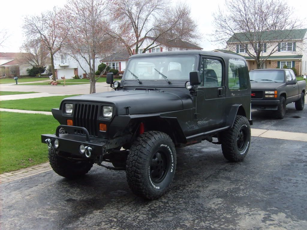

I did a krylon special!!! Heres the results

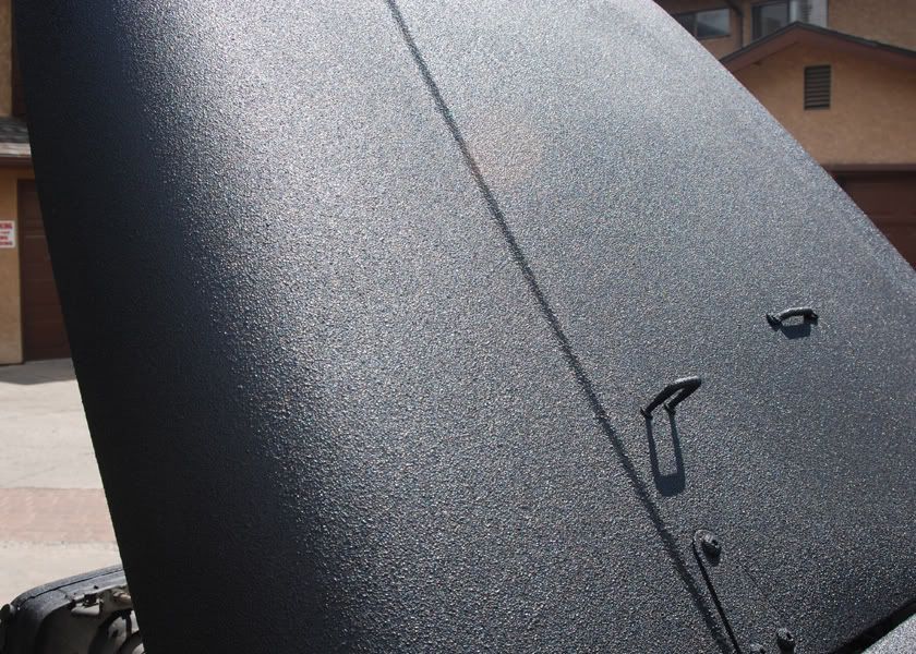

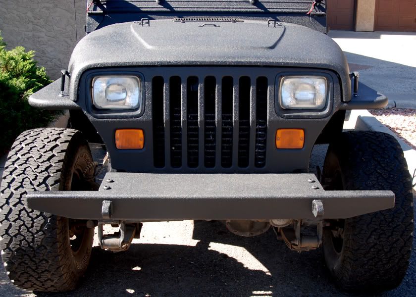

I did a Krylon job and after a year it faded and got chalky.
So I got a kit of Raptor Liner. It comes with a gallon (in 4 bottles) of bed liner and the spray gun. You just need an air compressor. It's not for everyone though. I have one kit on the exterior, plus one extra bottle for the doors. I have 3 bottles left to do the hard top (when I get it out of the barn that it's in for the summer) and some touch ups if I ever need to.
I sanded it down and degreased for the Krylon job. It stuck, but faded. For the Raptor liner I jsut took a wire wheel to it and scuffed the heck out of it, then cleaned it with turpatine or somethign like that. The prep for the Krylon took me 2 days. Adn a good 1/2 day to shoot it.
For the Raptor liner it look me maybe 2 hours to prep and 30-45 minurtes to shoot.

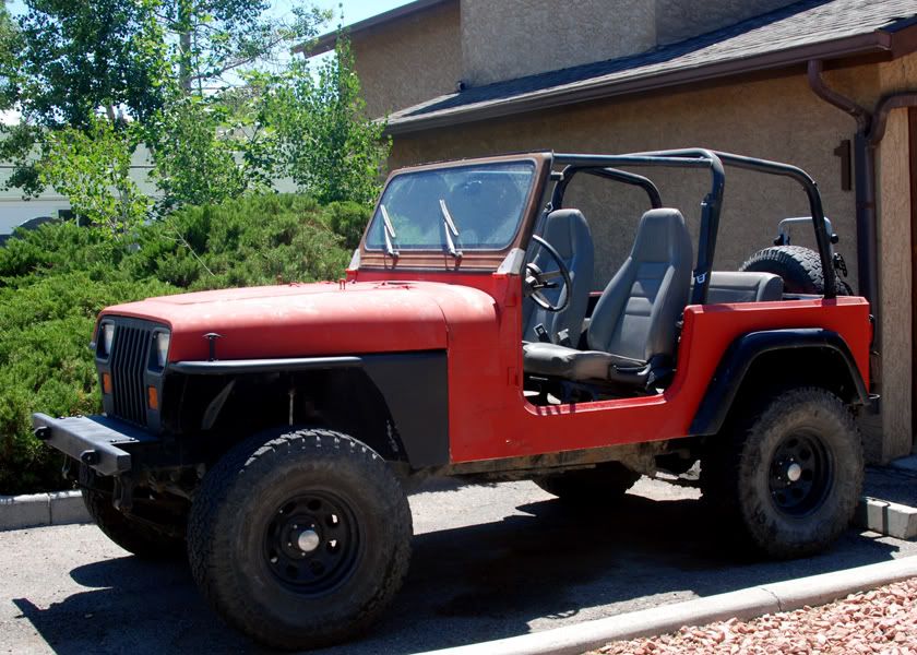

I went with SherKem from Sherwin Williams. Its a single stage High Gloss Tractor/Industrial equipment paint. I've only had it painted for a few months so i dont know long term but I like the result. Its around $150 once you get some hardener and Xylene.
From this,
To this,
1994 YJ, 4.0, SOA, TSL-SX 38x12.50x16.5, D44 front(Aussie Locker), D60 Rear (Spool), Custom Stinger, Smittybilt Rear Corners, Smittybilt Rock Rails, Smittybilt Tube Fenders, Warn CE M8000, York On-Board Air - www.metatrox.com
