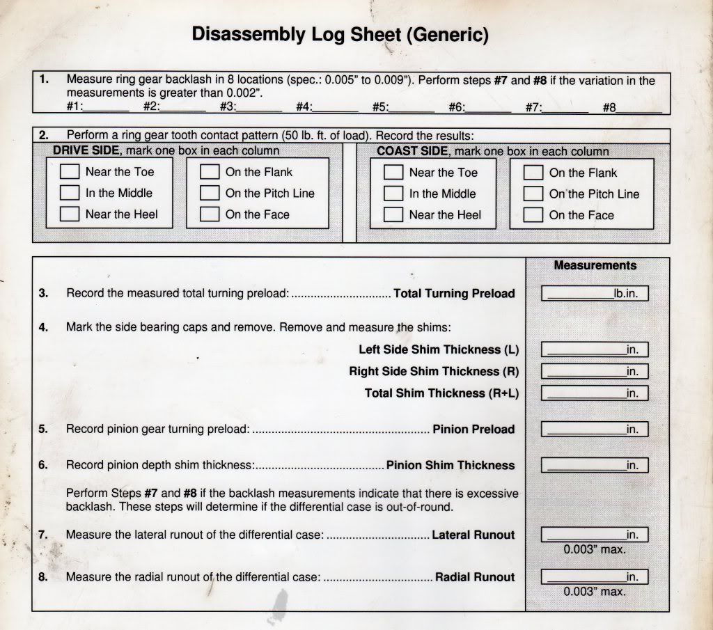

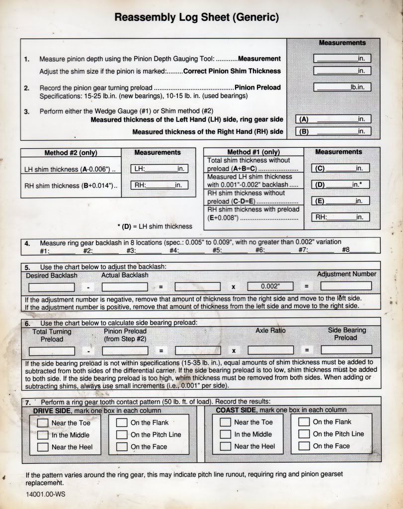

The case spreader is optional. The side bearing preload can be measured with an inch pound torque wrench. A hydraulic press is needed change the inner pinion bearing, carrier side bearings can be installed without a press. The following sheets will give you the numbers and order. These are from GM school. Ron
