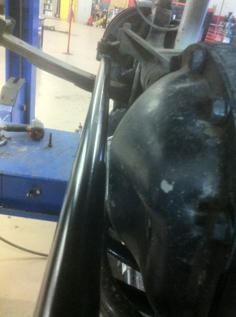

I run the 4wd hardware diff protector. I bought it when it was $50 and now its over $80. Still cheaper than most full diff covers and you don't have to drain the fluid to install it.
Notice the rust on the verticals? Yeah. Its been hit a few times. Works just like rock sliders.

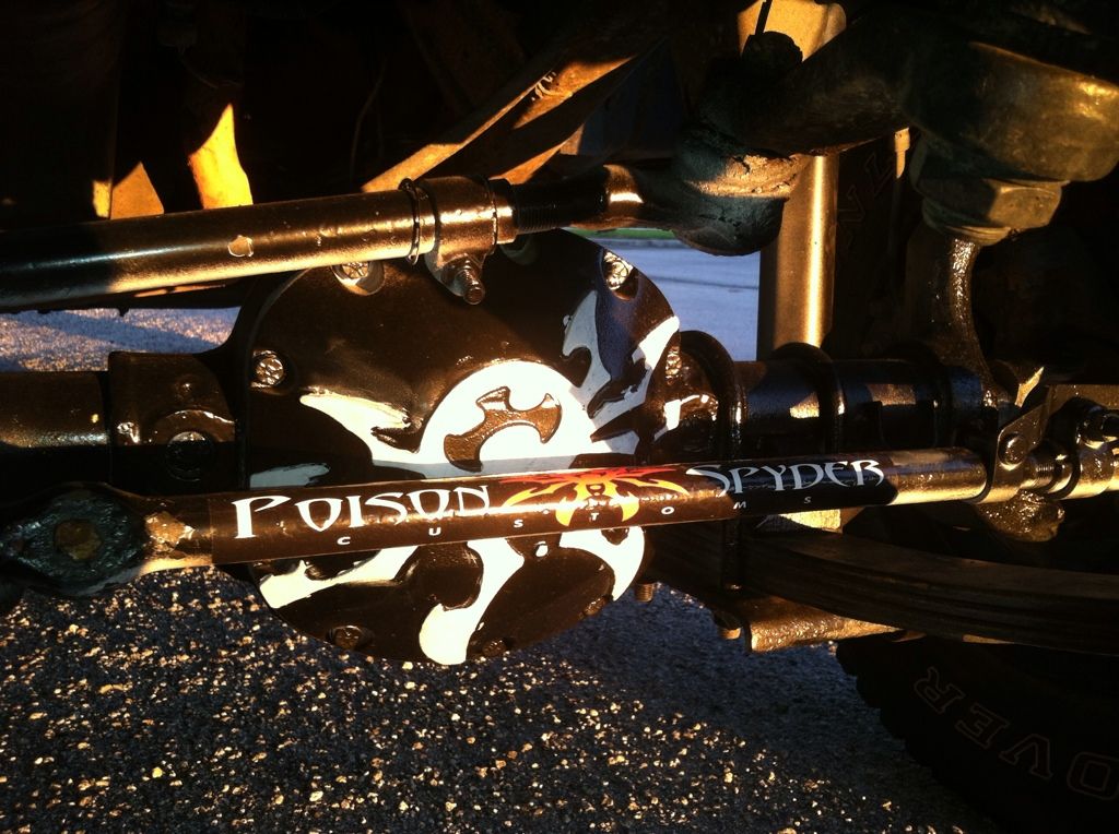

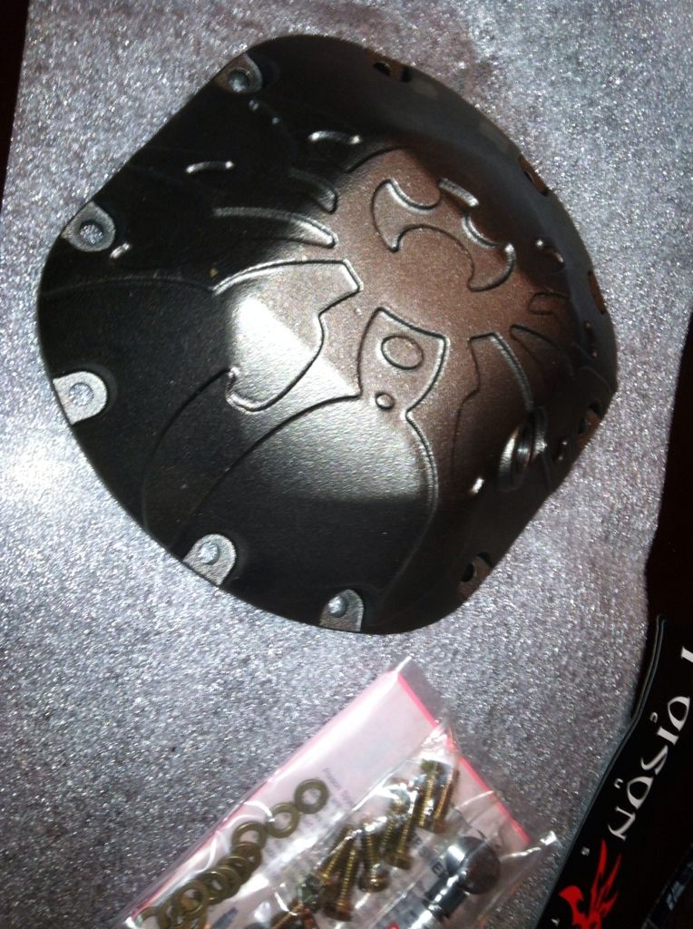

Just another option to the pot, I run the Poison Spyder Bombshell Diff Cover. It is ridiculously solid weighing nearly 12 lbs. it will take a hit and keep going for sure.
Came with all hardware and RTV as well.
Luck Favours The Prepared

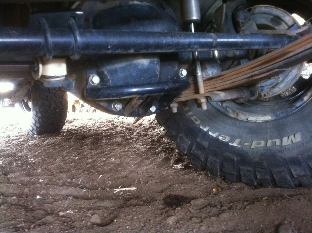

I run riddler covers with lube lockers gaskets and love them. Set me back 230 for both the 30/8.8 cover and gaskets, I would do it again in a heart beat I much prefer covers over guards. You more than likely need to change out the gear oil any ways and this is a good time to do it IMO!
