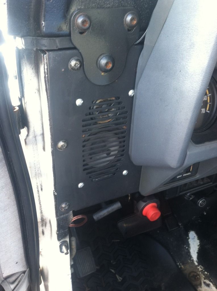

Installing new stereo and speakers need to remove the dash to rewire speakers. Does anyone have a thread to do this? I've layer the windshield down installed the new stereo and some bolts under the windshield. Is there a way to just pull the dash down a little bit to rewire or do I have to take the whole thing off and do I have to unscrew all the dash components to pull it out. It seems like it is holding on by one mystery bolt somewhere. Any help would be appreciated. Thanks.

Off or can I pull the whole dash off a little bit access the speaker wire. If any body has a thread. I looked but couldn't really find a good description. Thanks guys.

post #5 of 13 Old 05-02-2013, 11:00 PM
p2555016zr
Location: Las Vegas
Posts: 47
I think you have to remove the guage plastic there and drop the steering wheel. It gives you just enough room to get behind the dash and replace the speakers. Use speaker connector adapters. It will make it plug and play. I had to use washers to keep my speakers from being squished against the dash after installation.
p2555016zr is offline
post #6 of 13 Old 05-02-2013, 11:02 PM
p2555016zr
Location: Las Vegas
Posts: 47
I think you have to drop the ac assembly as well. Just the mount screws.

Ok I think I know what I need to do. I am going to work on it tomorrow night so I'm sure ill be back with questions I've done it before but can't remember how we did it. Thanks for the link that helped.

Just my opinion but I'd pull everything (pads, covers, gauges, etc.) and then pull the dash frame as well. It should only take you about 30 mins to do so. You will have to drop the AC unit on the bottom of the dash as well as remove the steering wheel.
That way you can check for rust on the firewall and on the dash frame which is all too common.
While you have the frame off drill out mounting holes for the front speakers. Give the frame/firewall a few shots of paint if needed to prevent rust, reinstall and you'll be good for a looooong time before needing to do it again.
