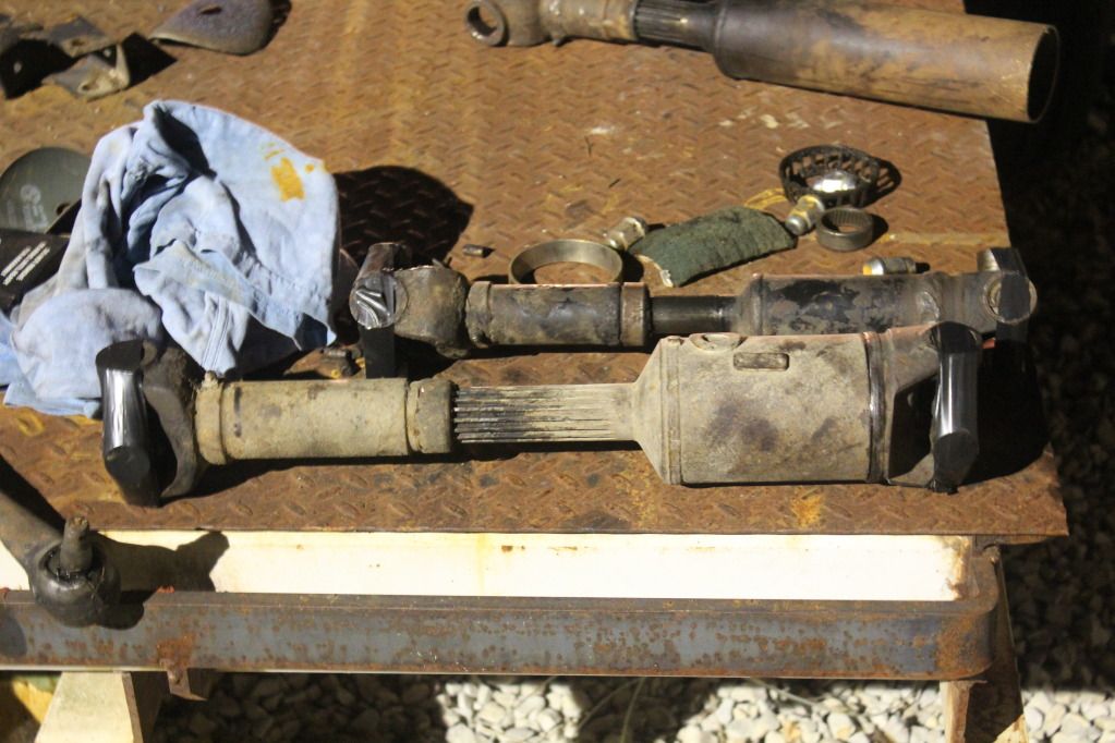

New rear driveline(bottom) vs old one(top)

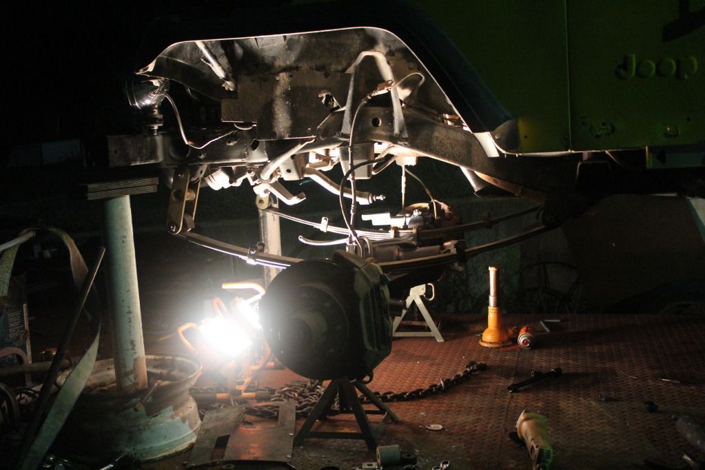

a daytime pic of front holding its weight

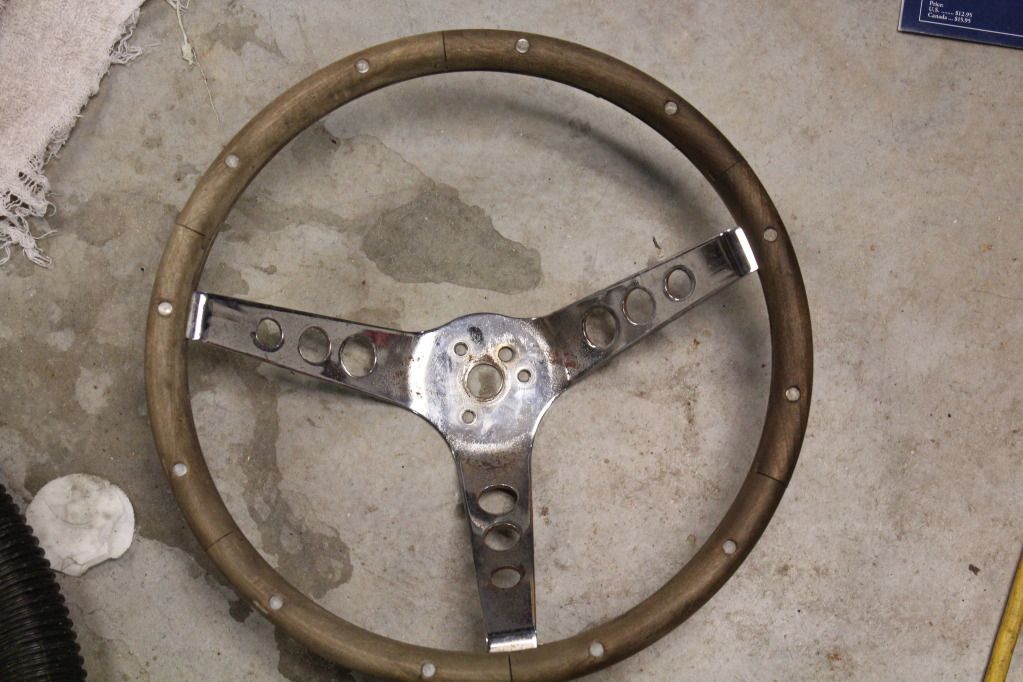

Not much else done but ive found my new steering wheel!
That looks like beef Nice work sir.
