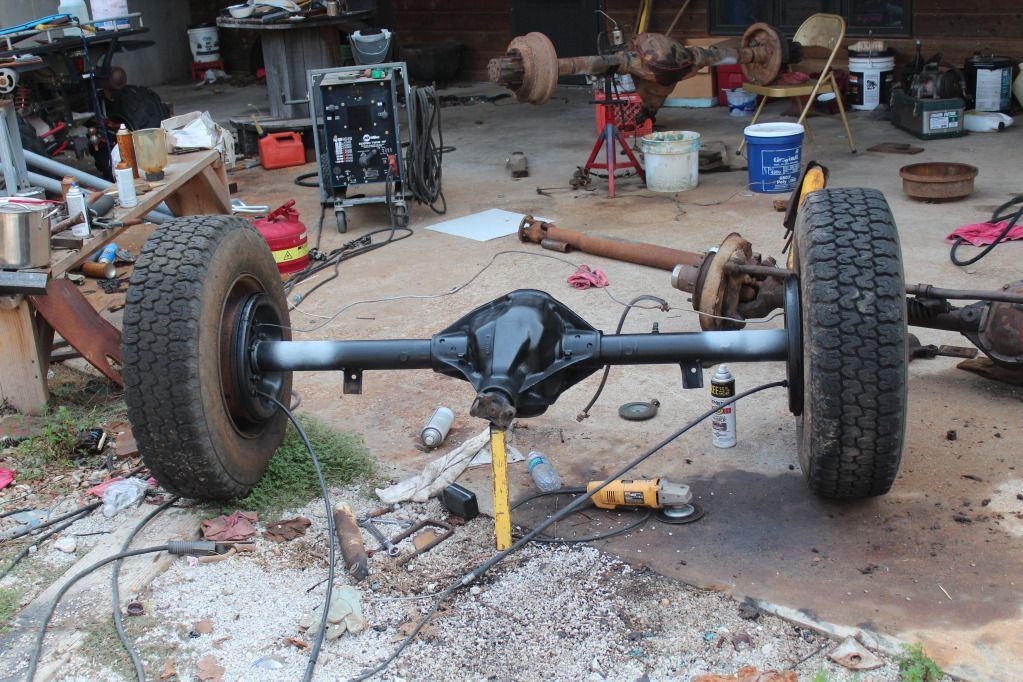

post #13 of 86 Old 08-12-2012, 07:47 PM Thread Starter
fuzzy89
Location: Springfield, MO
Posts: 82
44
60
fuzzy89 is offline

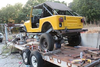

post #15 of 86 Old 08-12-2012, 07:59 PM Thread Starter
fuzzy89
Posts: 82
Just starting to take it apart
60 test fitted in
