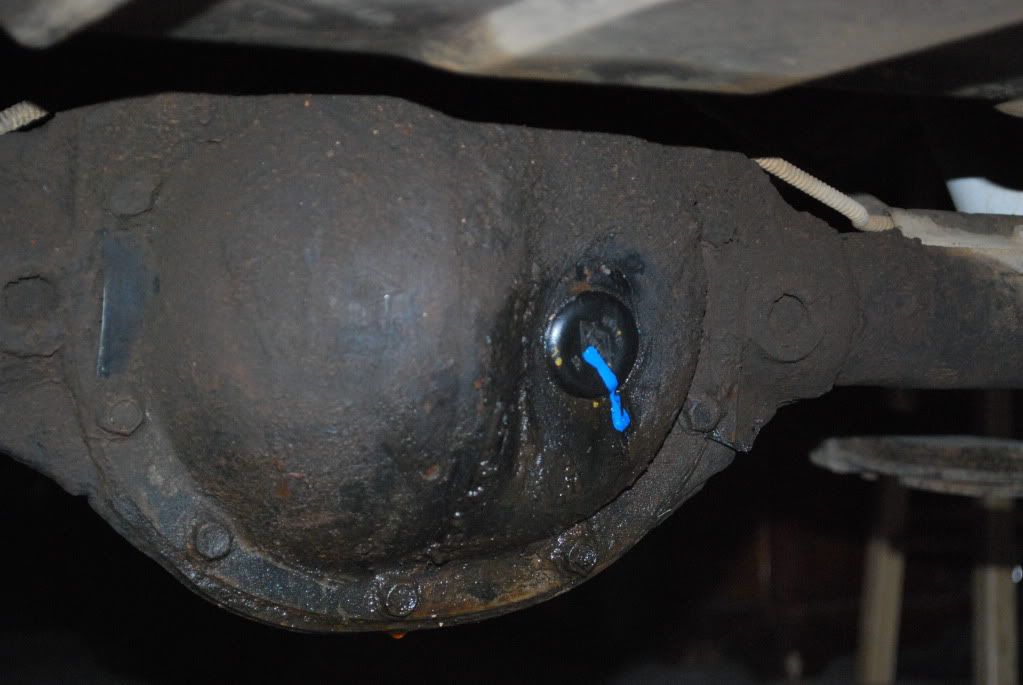

i was curious to why my rear axel would be leaking?

Where is it leaking from?
It could be several reasons - seals, tube rotated in the diff, vent, cracked tube, breather block, diff cover seal, rubber diff cover plug etc.

i'm not very good with names but the big part where the rear driveshaft connects... it's leaking out of the bottom of that

got a picture?

The D35's do this. It is to let you know your D35 is being lubricated properly. If it quits leaking then you need to add more into the hole with the blue stripe. Please note my sarcasm. The pavement where I park at my apartment is as black as the day it was paved due to this.

But mine does that too, not as bad as yours though. Its a YJ it will leak.

looks like you need to cap it that looks like a plastic plug shoved in there
that's the factory plug. its a rubber plug that is just pressed into the dif cover.
the blue paint mark makes me wander if it has recently been serviced, and possibly overfilled?

That baby needs to have some degreaser sprayed on it & cleaned off.

i bought it in april and the guy that had it before didn't really know anything about it.... but i haven't done anything to the axles sense i got it. what kind of place would even do that? and what is leaking out of it?

You can pull the cover, clean, inspect, replace the cover with fresh RTV, refill...
