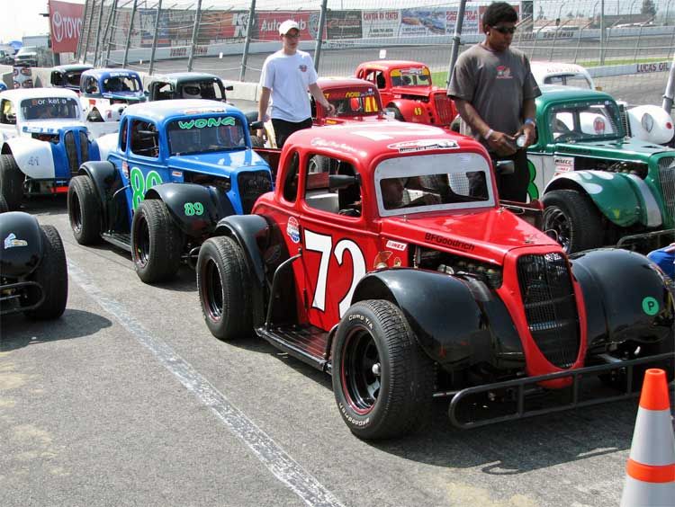

Originally Posted by maverick5751 View Post
im looking to build a trike from a Honda Goldwing 1500 .what dana 30 would work since its reverse drive.i will shorten it to my whith,i need disc brake one,
Since you replied to a 6 year old post and not started your own and its your 1st post...
The 30 is a front and not good for what you want.
You want a Toyota corolla axle or celica rear axle back from the 80s or 70s./
You can flip the axle to change direction of rotation. they are short and STRONG.
Look into the legend cars
to the above... this is a 6 year old post..
