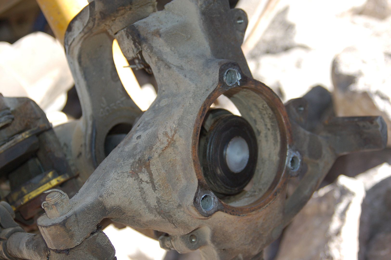

Personally, I stayed with 27 spine rather than 30 because it's WAY easier and cheaper to have spares on hand.
Also, here's what I think of Alloy USA after the first 1/4 mile of trail on brand new shafts.
Here too

Jbolt- I have AlloyUSA shafts...knocking on wood. So far so good. 30 spline shafts and fancy u-joints.I am still a bit careful.
