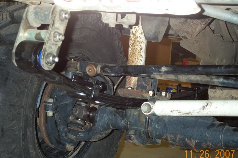

The Teraflex route only raises the drag link and not the tie rod.
The tie rod still hangs low...
I looked at the Teraflex, the JB4x4 bracket and the Rocky Road YJOTT systems when I did my D30 SOA.
I went with the Rocky Road YJOTT.
It raises the drag link and the tie rod so they are both above the springs!

The springs in the pics were just temporary.
The ones I'm running are BDS springs.
