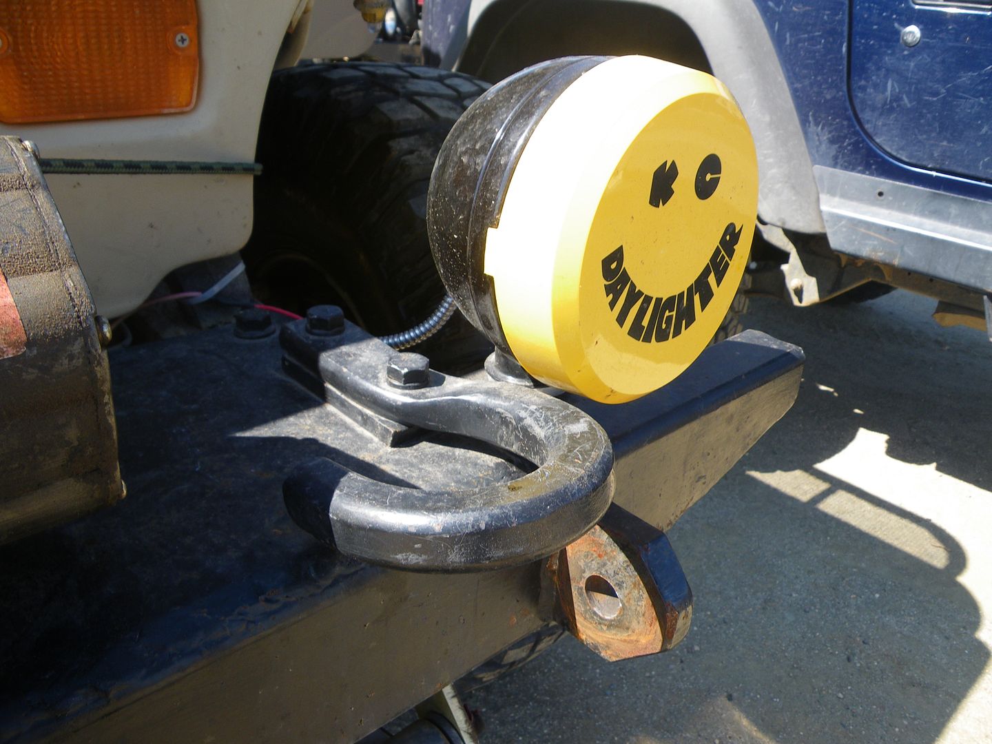

I have these, tow hooks from a chevy/gmc truck. The holes line right up with the existing hook mounting holes on a YJ. Just need to drill them out larger because they are threaded. ez on, ez off for tow straps.
