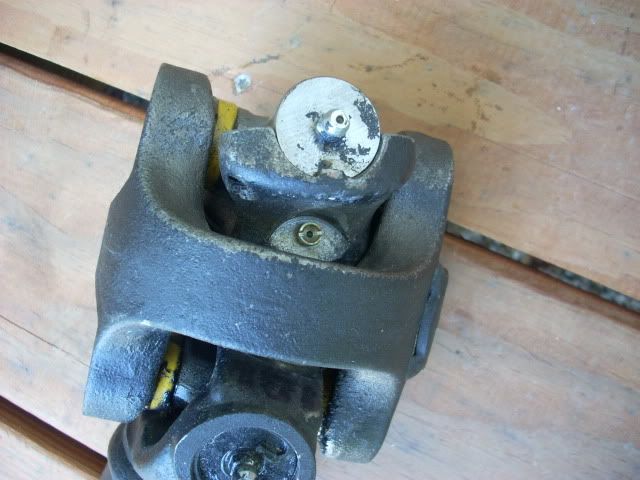

I took the driveshaft out, drove it down my street withg the front wheels sounds are gone.. The rear driveshaft sounded real bad at speeds about 10mph.. Heres some pictures of what I have..
Heres the drive line angle, so I'm sure it's not caused be the angle..
How do I grease the center ball?
Using a needle adapter on your grease gun. Grease where the arrow is
Thanks.. Shouldn't this have come greased from tom woods?
I've never bought a new driveshaft, but I wouldn't assume that it was pre-greased. Judging by your picture there's no grease on the ball. I'd grease all the zerks, doesn't hurt to make sure.

Originally Posted by Axl Jack View Post
What he said. I grease everything I can (ball joints, driveshafts) at every oil change. Only takes another few minutes.
I greased the ujoints and whatnot before I installed it, they were full.. I have to goto the parts store and buy a fitting for that...
