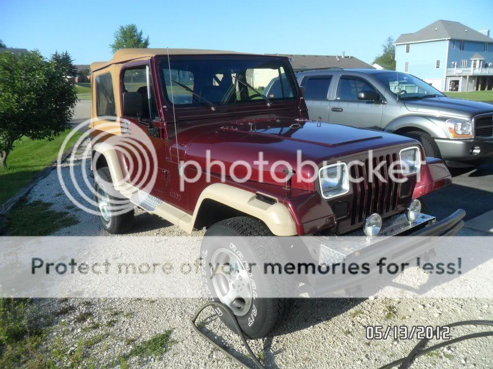

Mother's Day 2012. The day she came home. 30x9.5's. 3" body lift. Stock suspension.

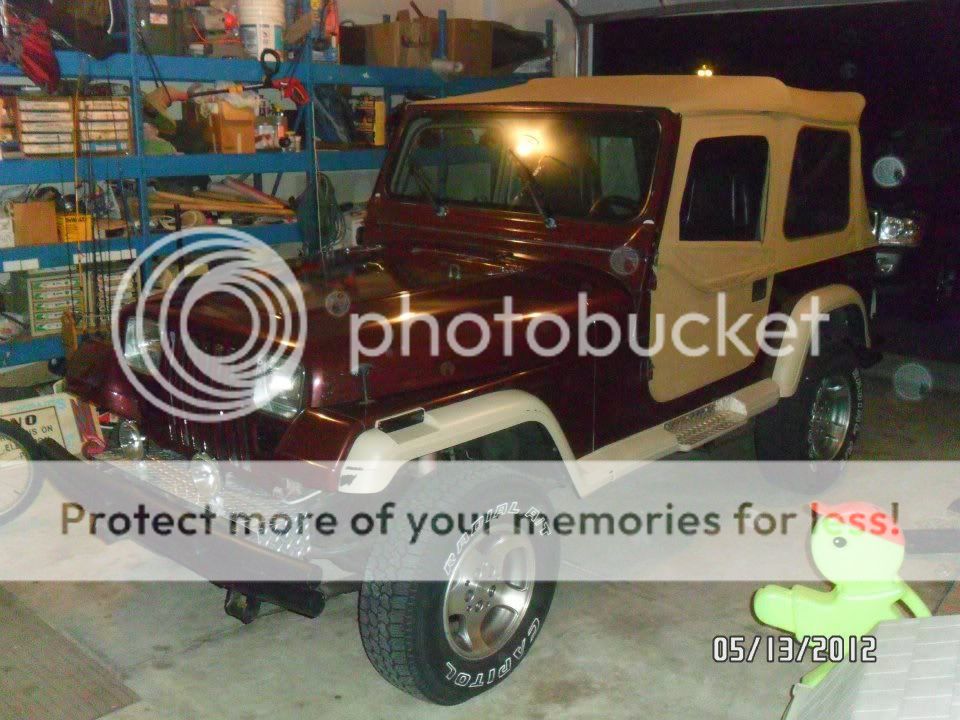

As she sits now. 2.5" OME suspension lift. 1.5" body lift. 31x10.5's
