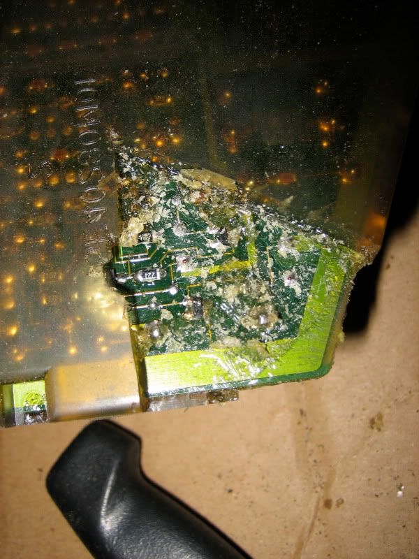

Hardest part wand removing the RTV from the board.

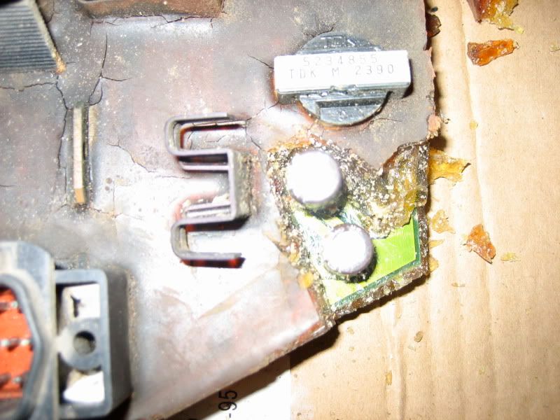

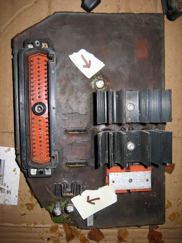

Yes, do it your self would be cheaper...parts cost was $ 7.20 for 3 caps . My caps had lost their
plastic shields so I did not feel comfortable pointing the "stripe" towards the heat sink tower to
line up the polarity correctly.

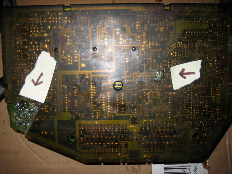

ok i did it today, first i tried to start the heep. 28 deg. crank,crank, no start or cel. put blow dryer on ecu for 10min. turned key cel came on and it started. so i figured it was this ecu problem. went to radio shack spent 4.50 and dug in. first off i have the 4.0L and the caps are in different spots than the other pics but they are the only 3 big ones on board. truthfully the hardest part was removing the old silicone. couldn't figure out the polarity by looking at teh caps so i went with the putting stripes the way they were on old ones and that seemed to work. took about 45min from removal to final silicone. tested it before i put final silicone on and it stared right up. then i realized it was warmed up from doing it in the house so the real test will be tonite or tomm morn.

BTW mine is a 4.0 94 YJ. I had 3 220uf caps..(no 470 uf caps)
