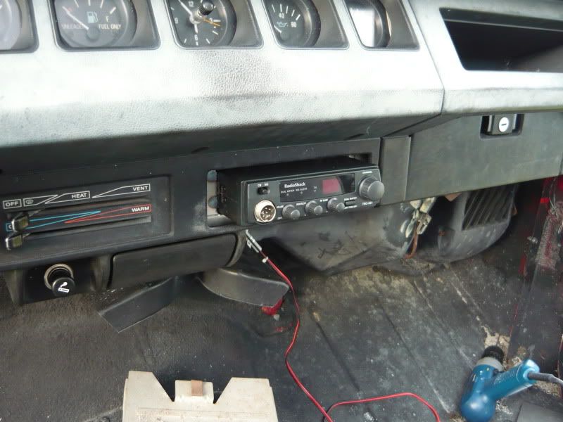

Oh yeah, another thing to check--seen in Mean Max's picture, there is a slider on the right around where the passenger's knees would be. Make sure the slider has the metal rod in it (which controls the heated air/cool air ratio).
