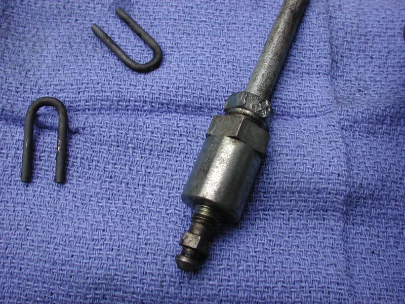

On your AX5, it should be poking out the front---wait, DUH, I meant out the back on the opposite side of the bellhousing. Kinda looks like this:
Good luck on getting that bugger loose.......

looking at the 2 pics I posted out looks like the pic you have.

Look at this pic that I found. That is were it should be. Passengers side up toward the top of the bell housing. Listen to Opihi59, he helped me out with a tranny issue. Go OEM. It's not fun pulling a trans. Heavy and you'll want to do it right the first time. Like he said,.if you're going to pull the trans to replace the slave, replace the clutch, pressure plate pilot bearing, input shaft seal and rear main seal and you should have the flywheel resurfaced while you're at it, but there are many that will disagree with me on this. If it's not grooved you can just smooth it up with some emery cloth.

What happened to me is that the bleed valve flops around when the Jeep is running .When you are clutching it the pressure and fluid bleeds out so that is why you don't see any fluid on the ground.What happened is the rubber isulator boot comes out /off letting the line to move.It looks like yours is gone.
