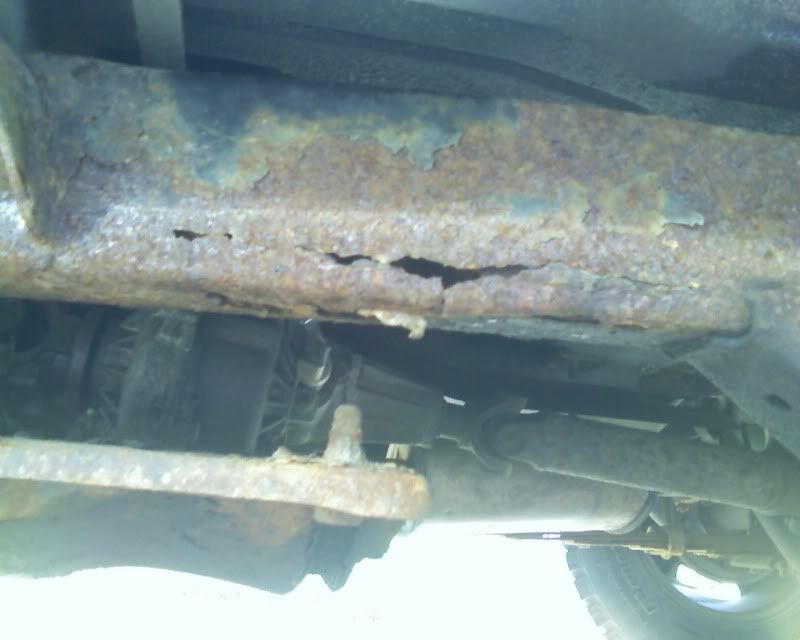

This is mine just after I bought it. Thats the crossmember completely rusted away from the frame. patch panels cut, welded, and ground. don't panic, make friends with a good welder.
