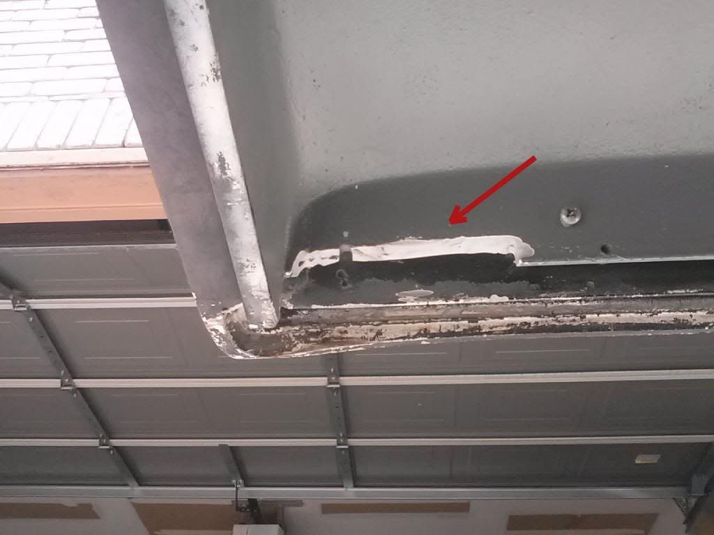

I had the exact same problem. All I did was took a grinder and cut out two slots on the inner "lip" the top that were hitting the cross bars. I will say the grinder probably isn't the best thing to use though. It heated up the fiberglass and it melted and dripped all over. It worked, but was a bit of a mess. I'll try to post a pic tomorrow when I get home.

It looks like it fit pretty well! Here's a pic of what I did to mine. This is the driver's side. The arrow points to the part I cut out.

That is exactly where I'm going to cut when I get time. You wouldn't believe the sound difference with my stereo compared to the soft top. Wow. I have 2 250W RMS Kendwood 6X9s powered by an 850 Watt amp. I can now hear every bass note. It was already loud, but now I can hear everything. My next step is now to get A/C. I've been trying to find someone selling theirs on craigslist, but no luck. I may have to save up for a JeepAir kit. New is nice, but I don't have the resources to get a new system. Do you know what kind of weather stripping I can use? I need to find out where to get the strikers for the ACME fiberglass doors. I have to have those doors on, they are sick! Window on the bottom and top. I still can't believe I got all of this for 200 dollars. Here's another picture.
