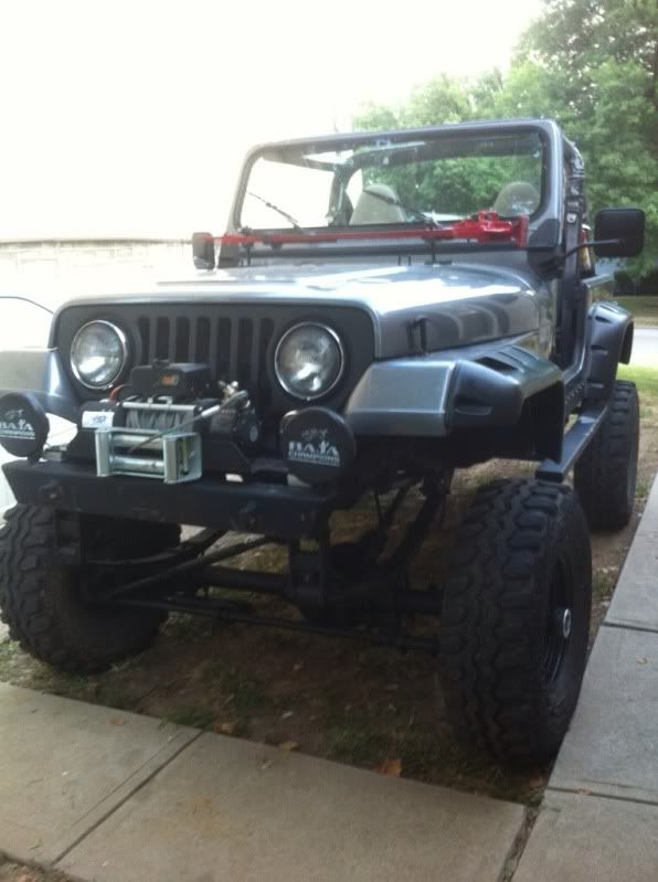

Here is what I've done...
I grafted a cj grill and a yj grill together.
