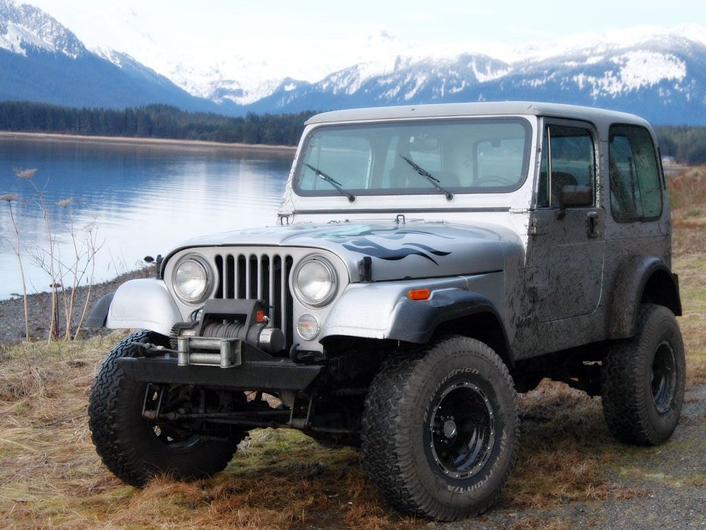

Two years later, finally got it all one color. Was a ton of work and a ton of $$$ for the auto paint and really wish I had more time for the body work but the good painting weather was rapidly running out up here in Alaska and I was determined to get this thing painted. Did a frame swap on it as well this summer so hoping she'll last quite a few more years now. The hood was in real rough shape and as soon as I sprayed it every little screwed up area really jumped out. I threw the vinyl flames on partially to cover the poor body work but also for my 8 yr old - he digs em. Lesson of the summer - simply feathering paint chips or small surface rust is not enough - gotta glaze coat em all! This was all done this summer - started in June and just got it back on the road this week.
