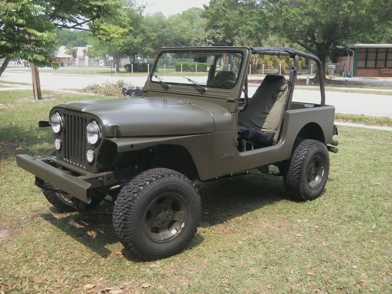

almost complete...

are you leaving the front fenders like that?
not sure just yet. I may put cj fenders on it eventually.

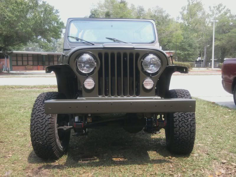

With lift
I put 2.5" Pro Comp lift and disconnected the sway bars for better articulation.
