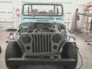

I just started my swap.
This was yesterday.

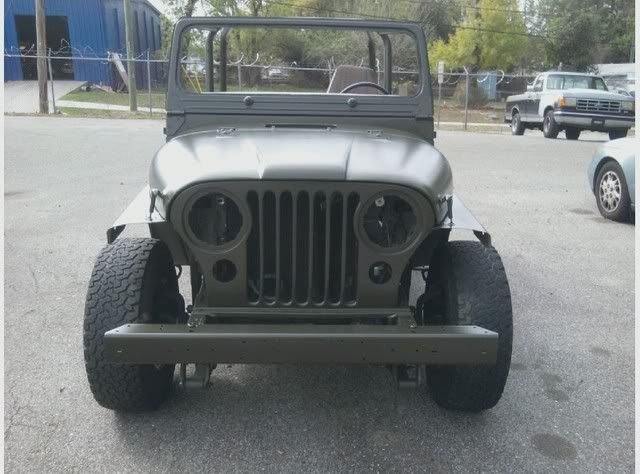

This was today. Got a long way to go still. I need to install the radiator, fan shroud and power steering reservoir. I'm keeping the yj fenders for now. I may change later. I'm just gonna cut them up anyway! I don't know why my pics load this way...

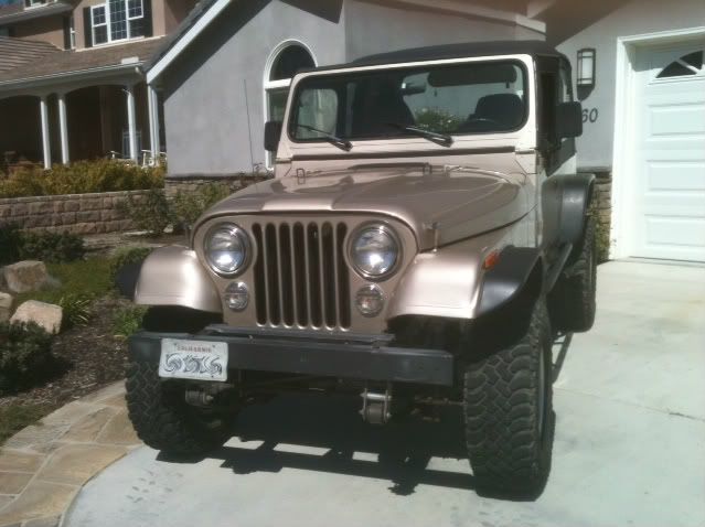

heres the one i did.
its like any project if you throw it together its easy. if you want to do a nice job and make it look like it was factory it isnt. we kept everything stock like the airbox, reservoirs, etc. if you dont want to use a body lift you need to trim a bit more. you can see the notches in the lower corners of the grill. i welded in portions of pipe so it didnt just look like a cut. i rebuilt the center grill support so it was at the proper level. one thing people forget to mention is you need to convert the turn signal connectors as well. the headlights plugged in fine.
another thing to decide is if you are going to use true cj parts or aftermarket replicas. in this one we used a true cj grill. the fenders and hood were taking too long to source so those are knockoffs. you can tell the difference and its the only thing that bothers me about the conversion.

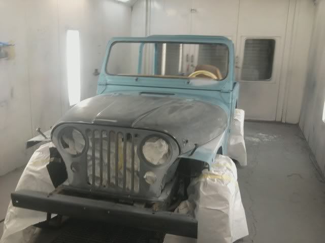

taped up and ready

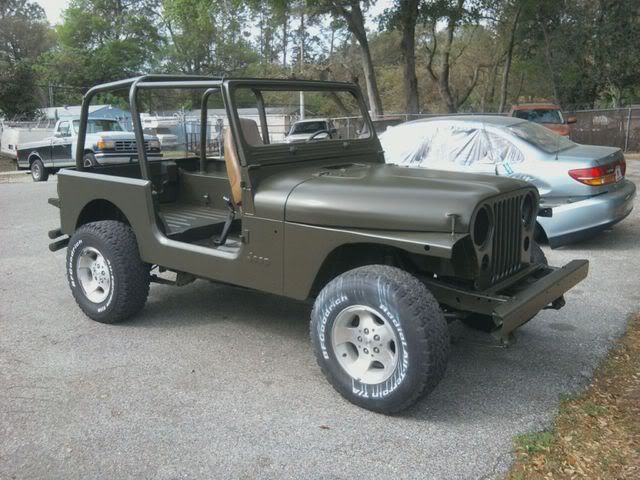

and painted
