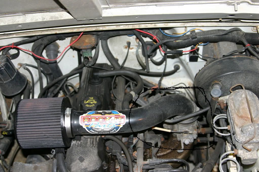

You are right, I will change the TPS or have it checked to make sure this is the problem. Based upon my engine codes, this is probably it. I found in the Haynes manual how to change the TPS. For the life of me, I cannot tell by the pictures where it is at. Can someone take a picture and show me generally wher eI should be looking at? Sorry, I am not mechanically inclined so its taking me a while to learn these things. I am learning a ton though. Just give me an idea where to look at and where it is located. Thx!

Thx Alfons. I do have a Haynes manual. It has come in very handy in replacing my radiator and a few other minor fixes. My only probalem is I cannot tell where the TPS is. I see pictures of it in my Haynes manual but cannot tell where it is at. Just looking for a pic of roughly where to begin looking. Thx!

Is this the right general area or am I way off?

Yeah, that is the right general area. If you take the tube that goes to your airfilter off you'll find the throttle body right in the area that you circled. It is more or less just a square piece of metal with a round plate in it that controls how much air moves through it (its a bit more complicated than that but thats okay). The TPS should be right on the side of the throttle body.
On second though the throttle body might not actually be square on the outside...but the rest of the description should hold true.

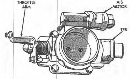

Check this out.
