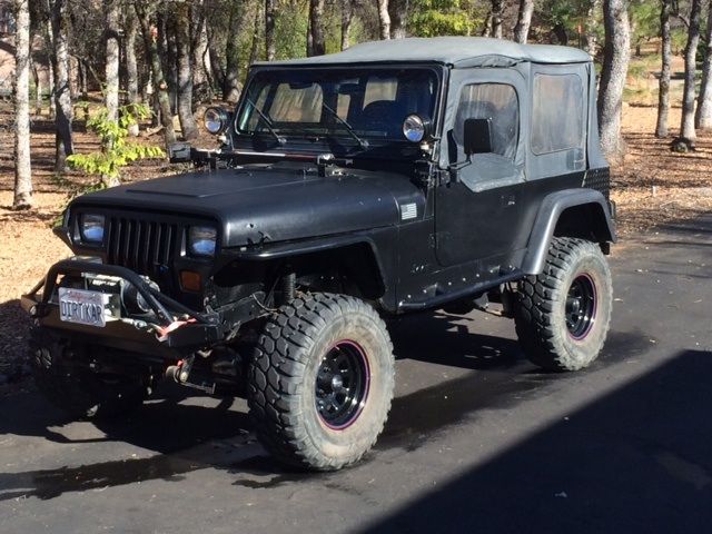

3.5" BDS w/ 1/2" booms, 1" bl, 1" MML, NO TC drop on 33's. NM, I have an SYE too. What makes you not want one? Benefits outweigh the cost&effort to install one. Just break that stock driveline once... Ask me how I know. This shot is with Revolvers up front which are about 1/2"-3/4" lower than the booms that are back on now.[/URL]
