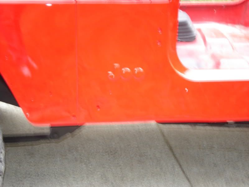

Originally Posted by Mr YJ
I think there was a lap joint that was spot welded at the factory and then sealed [but not very well]
I just welded in a replacement floor section from Q'Tec that had a 90 degree bend on the outside and then welded a new side panel to that. I was in the same position as you but mine wasn't as severe as yours.
Good luck and keep at it. When you're done, you'll be very proud of what you've done.

I'll see what pictures I can dig out when I get home, but all I did was cut out a plate and weld it. I did put a little spacer underneath the plate inside the box section though so that it'll withstand the clamping forces when I drill out the seat mounting hole.

Rusty,
Not the best picture to show what I did, but you can just make out some of the weld under the primer.
When I covered it all in Herc you can't even tell it was welded.
You can see that I had to do a little patching around the right rear seat mount too.

That pic actually helped alot. Thanx. did you weld over or line up the metal flush with the floor?

I cut the patch panel so that it would sit flush and then welded all around the seam. Followed that up with the grinder for a fairly flat repair. Luckily the surrounding area wasn't too bad so I had something to weld to.
